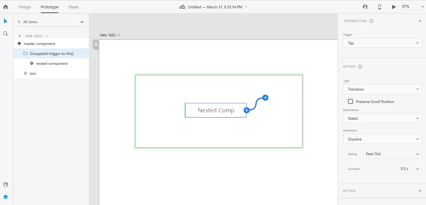

    Hey there, you can put the nested component in a group, and add the link to the master's state to that group instead.

    Spas K.
    Mar 31, 2022 5:13 PM UTC
    Hey, it's a bit confusing 🙂 It will stay a component. Just put it in a group on it's own. Then add the trigger to the group.
    (State2 on the right is the master's state, not the nested's)
