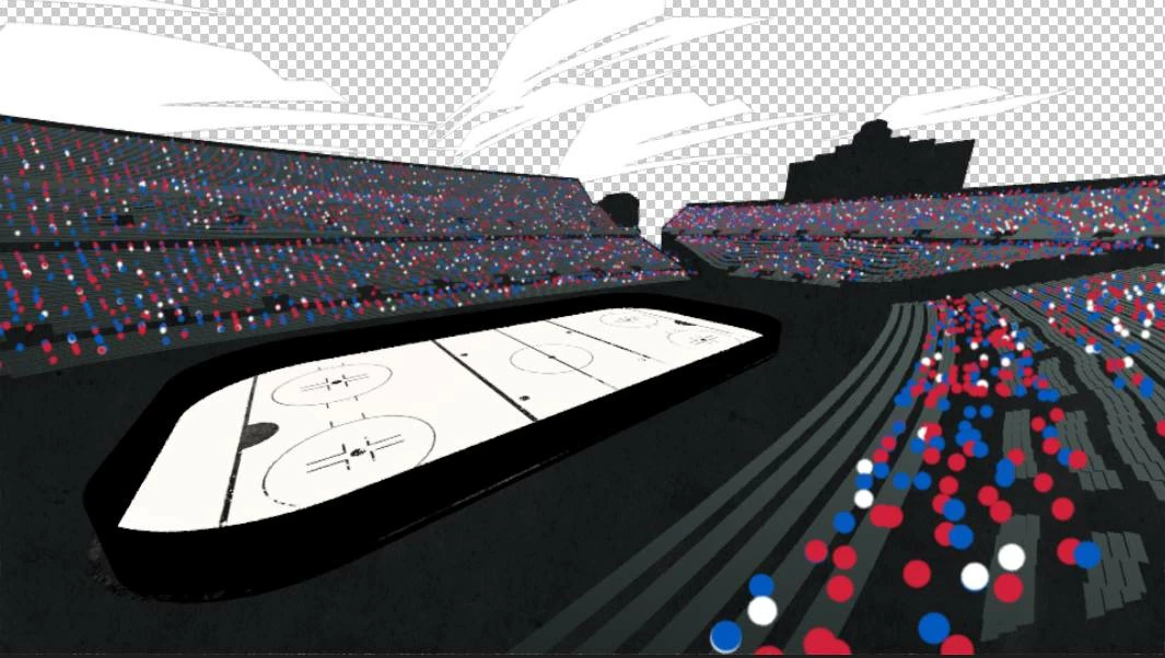

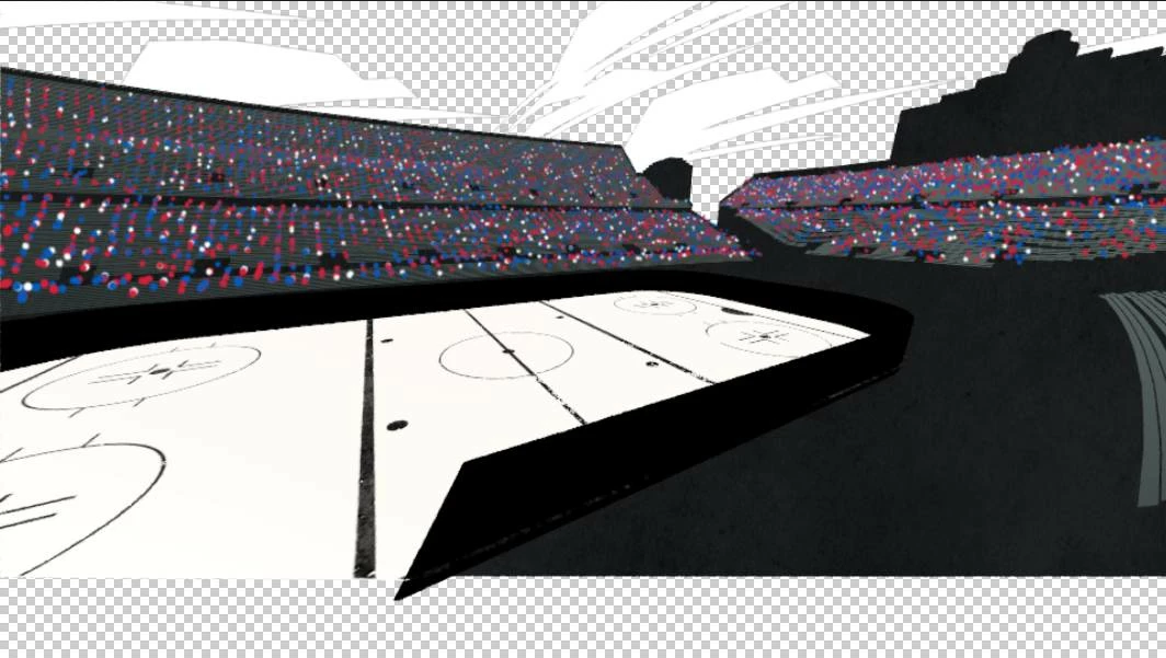

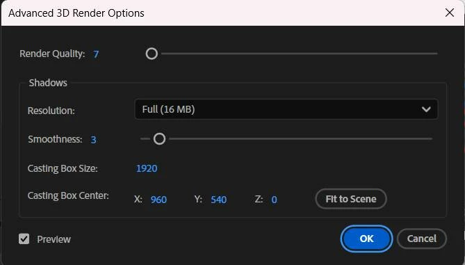

I am working in AE 25.1.0 on PC. I have a scene set up in Advanced 3D, using a mix of .obj and .glb files, alongside regular 2D and 2.5D layers.

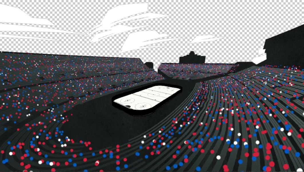

My camera starts wide before zooming in close.
My issue is that when the camera gets very close to these layers, they start to clip against the camera. I have not had this issue with Classic 3D but can’t use that renderer if I want to get the most out of the 3D elements.
I have tried adjusting my camera and 3D render options with no success. Any tips?

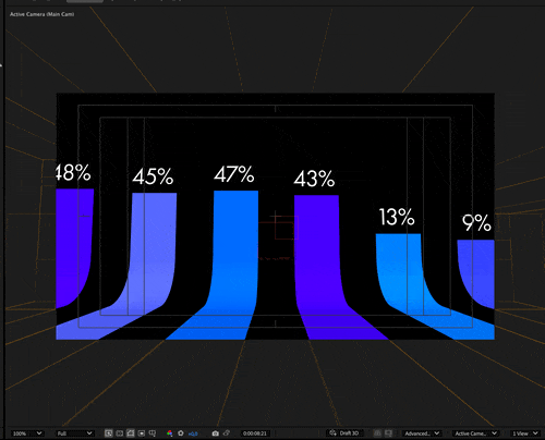

I have the same problem. I created an animated chart using Advanced 3D to be able to bend flat layers. Everything animates fine, but I have an issue where the layers disappear when the camera moves closer. I want to fly the camera between two bars of the chart, but I can’t. This problem doesn’t exist in Classic 3D. My camera is set to 28mm, so it’s not very wide.
At the moment, Advanced 3D imposes more limitations than benefits.

None of your screenshots show the cameras or the 3D layers' positions. Just two views would help. Your camera also has a very wide-angle lens, which suggests that it is very close to some of the layers. Layer order and offset can also contribute to 3D object stacking in the shot. We need a lot more info to give you some meaningful workflow suggestions.

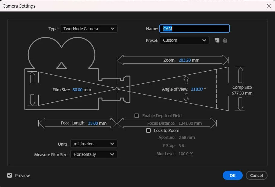

You have an incredibly wide lens (less than 10mm equivalent), but I don't see any difference between the Classic 3D view and the Advanced 3D view, and I don't see any clipping. Check out the video—I changed the solids' color and experimented with the Checkerboard effect.
I would try giving the camera a 15mm or longer lens. I'm still not sure what is supposed to be clipping. I don't see anything I didn't expect.

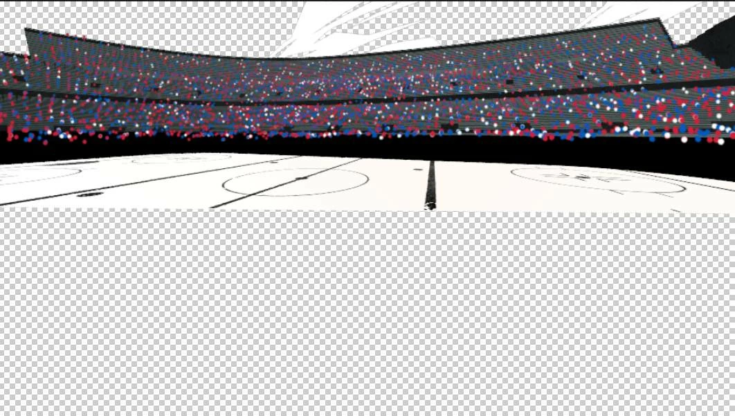

Please find attached a simplified version of the project, using just a solid as the groundplane. You can see how it clips against the camera towards the end of the sequence.
