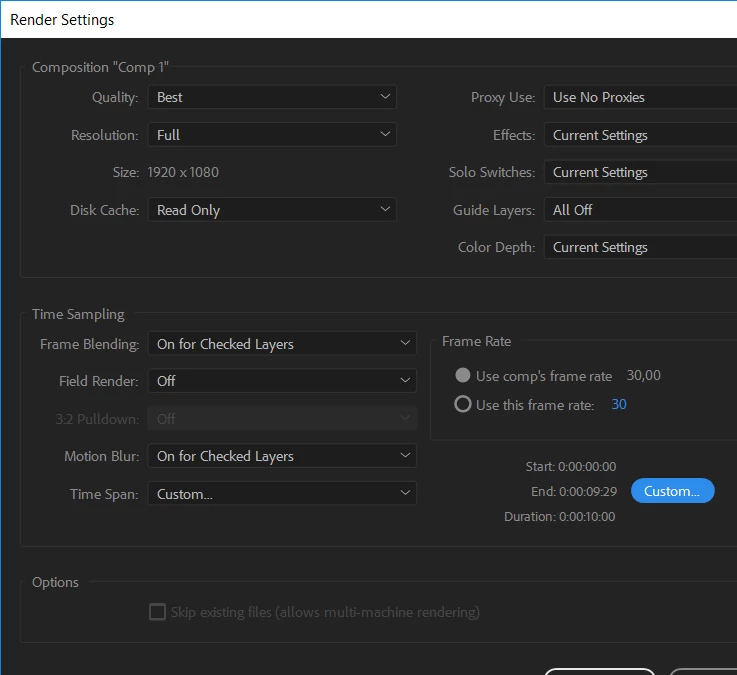

I create a black solid as a test and proceed to export with following settings:

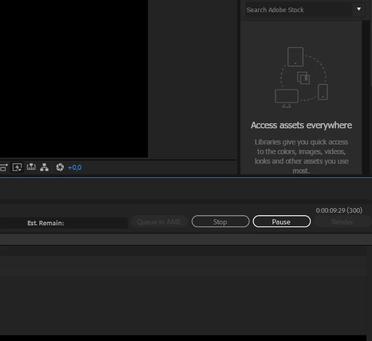

I noticed that the frame rate end is at 0:00:09:29, i tried to put it at 10 but I can not make it, it doesn't take the change (not sure if that's the issue)
Here it already says that 300 frames are 09:29 sec...

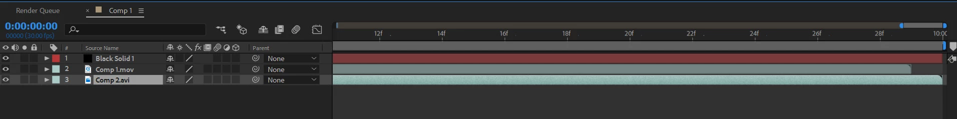

and when I put the exported files below the solid that genetared them, you can see that the .mov has 1 frame missing while the .avi is correct.
