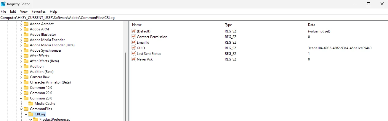

May 25, 2023 7:57 PM UTC
I checked NeverAsk is set to 0
I enabled logging, but also found some log files from when the crash happened (reveal logs): Link
May 25, 2023 7:42 PM UTC
The crash dialogs not showing up is also somewhat confusing. If you're on Windows, could you go into the Registry (RegEdit.exe) and find the path shown in the image and make sure NeverAsk is set to 0. Just want to make sure that the crash reporter hasn't been turned off which would stop AE from sending the crash details in.
