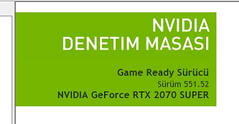

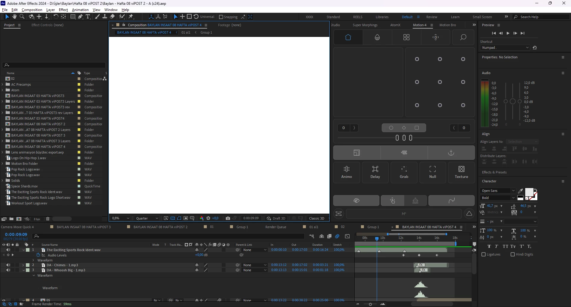

Feb 21, 2024 8:01 AM UTC
I have the same issue. The after effects 2024 (24.1.0) freezes for a few seconds, then the entire screen turns black, then after effects turns into a white screen (image attached).
After this happens, the Windows 11 interface also becomes partially unresponsive.
It's annoying because it can happen 5-10 times a day depending on how I use After Effects. To fix it, I restart Windows or log out and on. This is how after effects can work.

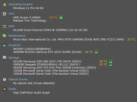

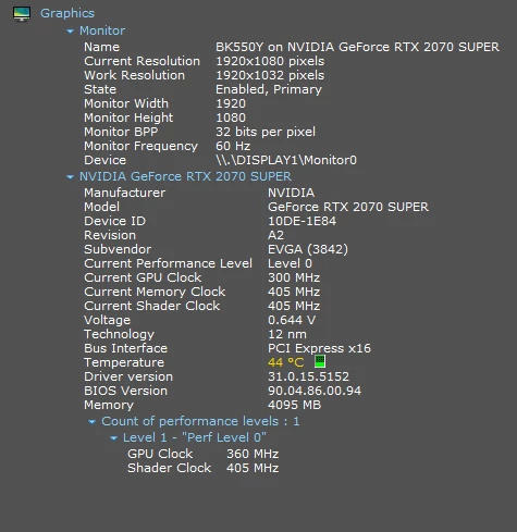

here is my PC specs:
the PC specs is in attachments.
Geforce driver version is 551.52 (its latest auto update. I tried an old version but the same issue)
thanks @nishu_kush @Rick Gerard
