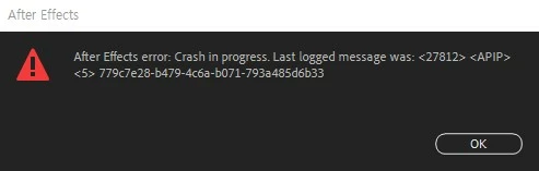

    Nov 24, 2022 3:03 AM UTC
    other crash
    after effect error: Crash in progress. last logged message was: <27812> <APIP> <5>
    Dec 4, 2022 3:33 AM UTC
    I have the same problem as well. I had my auto save set at 2 minutes and just checked it was somehow at 20 minutes. My computer crashed and now I have this errror and I lost all my work for the day on After Effects 23. Can't even open my project that I've been working on all week same error 33:4.
