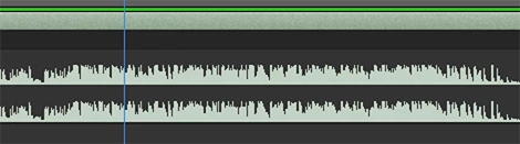

I wanted to bass boost a song so I imported it into Audacity and added all the required effects needed to bass boost it. I've used Audacity many times to do this and I made sure that the Audio didn't travel into the red area. I then exported it as a WAV file at 41hz with 32-bit PCM. Then I imported this file into After Effects and made a cool music effect to go along with the song. I didn't mess with the audio but after I rendered I noticed that the audio had become really distorted on the bass parts of the song. So I went back into after effects and noticed that the audio was red lining under the audio tab. No matter what I do the audio still redlines. I've tried different formats, i've turned the gain down, i've checked the settings for after effects and all of the sound settings seem to match up correctly in Audacity with After Effects. I don't know if there is a problem with my Macbook audio settings or even my Audacity or After Effects settings. So I really need all the help I can get.
My system is a Macbook Air 2015 running the latest version of OSX and the latest After Effects and Audacity.
It has 8GB of RAM and an i5 at 1.6ghz.
My system has no problem running any of these programs and can handle Premiere Pro and After Effects at the same time.
I've also been rendering with Adobe Media Encoder if that helps.
All my programs are the Creative Cloud 2017 editions.
Above is the audio area when it is playing the bass parts of the song and the second image is what my video looks like, i've also tried lowering the gain wit the sliders next to the audio area.
Any help would be greatly appreciated as I badly need this video to work.
Thanks!!!

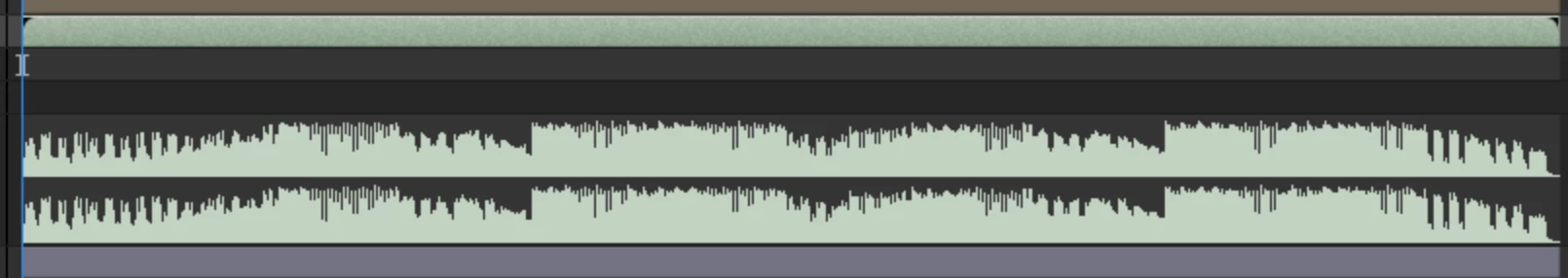

Ok, so i lowered the levels to -50 but it still distorts. The waveforms have dropped very low but i'm still getting distortion. I'll re-try boosting it in Audacity but this time i'll make sure nothing goes over -6 and aim for the sweet spot between -18 to -12. I am running the latest version of After Effects which is 14.2.1.34 on CC 2017.
Here is what the Audio and Waveforms look like at -50:
Although distortion is an issue i will try again with Audacity and see if that fixes it.
Thanks Rick Gerard
If you have creative cloud I would strongly suggest that you use Audition. I know that it is properly calibrated and produces video compliant files. I don't have experience with Audacity but suspect that may be part of the problem right there.
You should also spend a little time learning about equalization and audio production. It's not something you can just grab the knobs and tweak to your liking. There are rules that must be followed if the audio is going to playback on all devices as expected.

Cropped screenshots are not very useful for diagnosing a problem. The first thing you should do is deselect or select all layers in your composition and then press the U key twice to find all the modified properties. In your case you want to check for additional audio tracks and audio adjustments. You should also select the layers that contain audio and press the U key twice to check the waveforms.
The Boosting audio can be tricky. There is a lot more to audio production than just listening to the speakers. I should strongly suggest that you dive into Audition to do your audio mixing and stay up a bit.
The Audio panel does not change the gain of a Audio levels of a layer unless a layer is selected. You need to check the levels values in the timeline. Changing the gain of the audio track will not change the height that Audio Spectrum or Audio Waveform generates.
I'm not sure what you want here. If the waveform in the timeline looks clipped then your audio is clipping. I would check the track in Audition. If you want a different look to the Audio Spectrum effect then you need to monkey with the settings in the Effects Control Panel.
BTW, the standard for video (and audio by the way) is 48 kHz 16 bit stereo PCM WAV uncompressed. You can use 32 bit if you like but 44.1 is only the standard for legacy CD production. AE prefers the audio in this format.
Also, when using audio to drive animation I will often do a custom mix  of the audio to isolate certain frequencies or levels and render that audio track just to drive the animation. A normal audio mix is used in the production for the sound, the special track is only used to generate data for the animation.
If you can't figure it out show us a full screenshot with the modified properties and the levels and waveform of your audio layer or layers revealed and maybe we can help. I suspect that the biggest problem is your bass boost.

Sorry for the cropped screenshots, I'm pretty sure there aren't any additional audio tracks or adjustments and I don't own Audition, this is why I use Audacity. When using the Audio Panel I made sure the layer was selected, but it still seemed to distort, even when turned down. By the way the video is fine i'm happy with that, it's the audio that I need help with. I'm also happy with the audio spectrum effect. I've also re-exported in Audacity with 48kHz 16 bit stereo PCM WAV uncompressed and that didn't seem to help anything. My bass boost sounds fine in Audacity and doesn't distort or even touch the red zone. What do you mean by Audio clipping? I just want the Audio to not distort at all so it will sound good inside the program and when I render.
Here is a full screenshot:
This is what my after effects looks like as you can see the Audio Levels and The Audio Tab are both set to their default 0.
Moving them doesn't seem to change anything. The waveforms look good to me but I don't know what to look for.
Thanks for the help so far!!
August 27, 2017
Your waveform shows me that your audio levels are too high.
Your waveform:
Properly produced music track:
Notice that there is a lot more empty space between the left and right channels. You don't have a lot of hard clipping but levels are way too high for video production.
Recommended average level for digital audio is -18 to - 12. Your audio should never go above -6. It looks like you need to do a little studying on audio production. If you want to really drive up the bass and still get audio that will sound  good you need to learn how to use multi band compressor limiters. Audition is a good tool for this. I don't know much about Audacity but I can tell from looking at your waveform that your audio was not correctly mixed. There are also loudness (a technical audio characteristic) values to consider when mixing and equalizing audio. It looks to me like you need to do some studying.
Lowering the audio levels in the timeline should change the look of the waveform. Try setting the audio levels to -50  and the waveform display should be much lower. If it is not then you are probably not using the latest build for your version of AE, There were some bugs in earlier builds. Make sure you are running 14.2.1 if you are on CC 2017.
Changing the levels in the audio track will not effect the way Audio Spectrum generates it's display. The effect looks at the original audio track before you make any adjustments. The only way to change that rendering order is precompose the audio track after making the adjustments and then use the pre-comp as the source for your effect.
