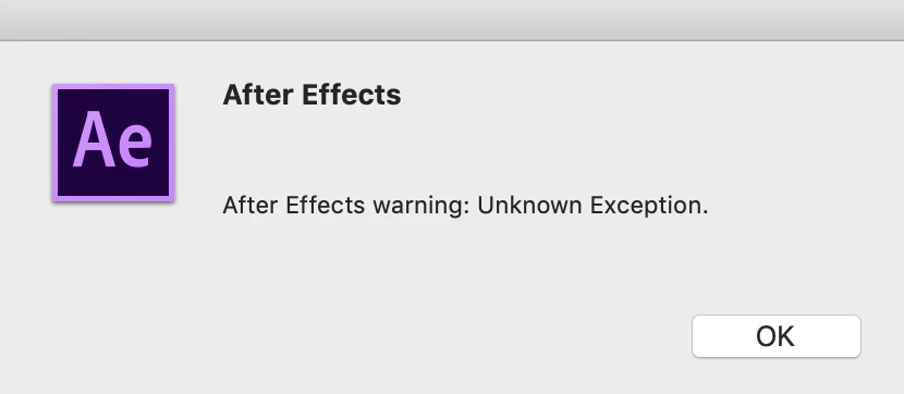

After effects warning: Unknown Exception MacBook Pro 15" 2019
Hi there,
I have new macbook pro 15" 2019 with Mojave 10.14.6
while i'm trying to open my after effects there is warning:

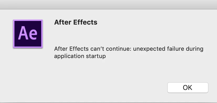

when i'm clicking ok:
i tried to uninstall and install again all of adobe files,
i tried to use the cleaner, i cleaned the preferences and chache files and tried to change the permission for almost all Adobe folders to read and write.
i'm stuck and it's super frustraiting. please help!

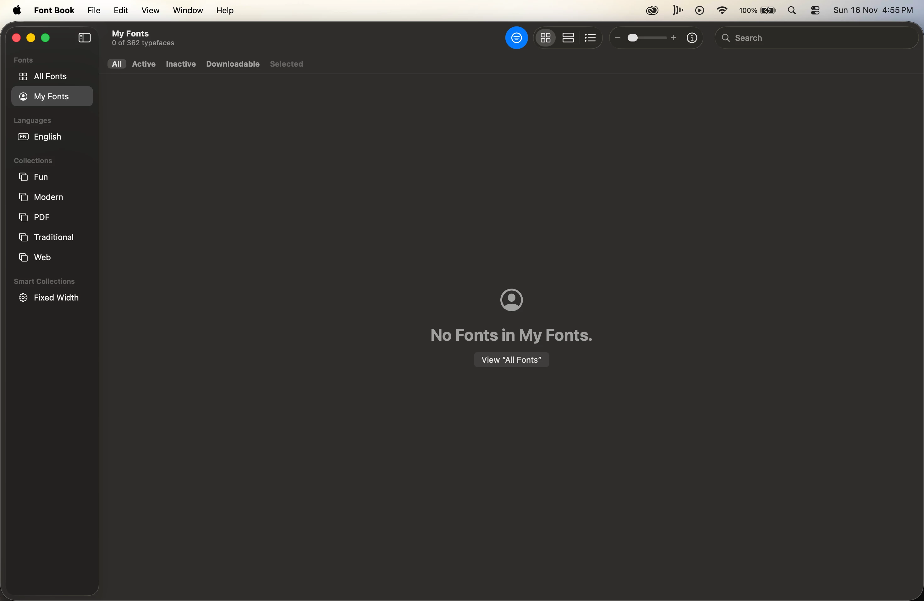

It turned out to be a corrupt downloaded font for me, too. To get rid of it: Open up Font Book, got to All Fonts, do a select-all to garb all fonts, then go up to File > Validate Selection. Let that run, and then look for any fonts with red alert issues and delete those fonts.
37 replies
Nov 16, 2025 11:26 AM UTC
how come i delete all my font but still facing this issue? please anyone help please
