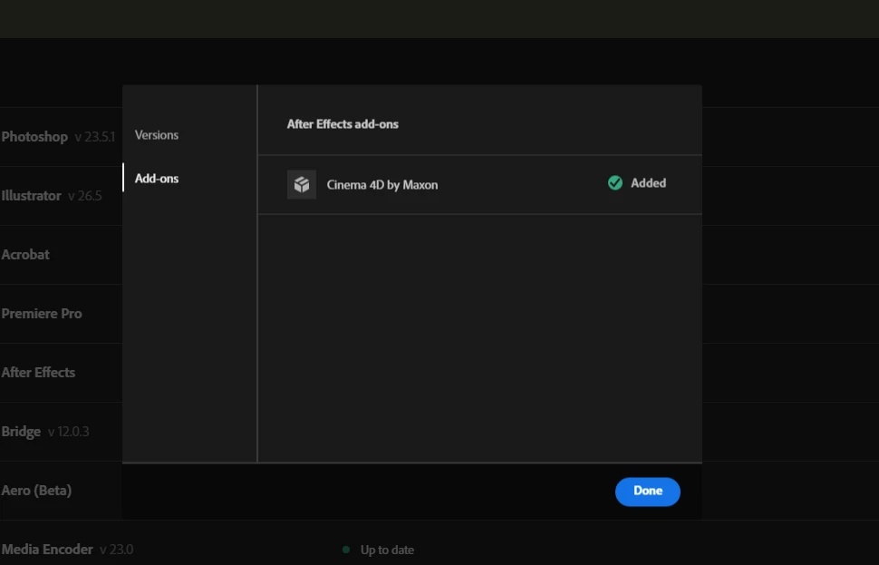

Updated to 23.0 and my project will no longer render with the C4D renderer. Extrusing and rotating text.
The Add-on is showing it's installed though.

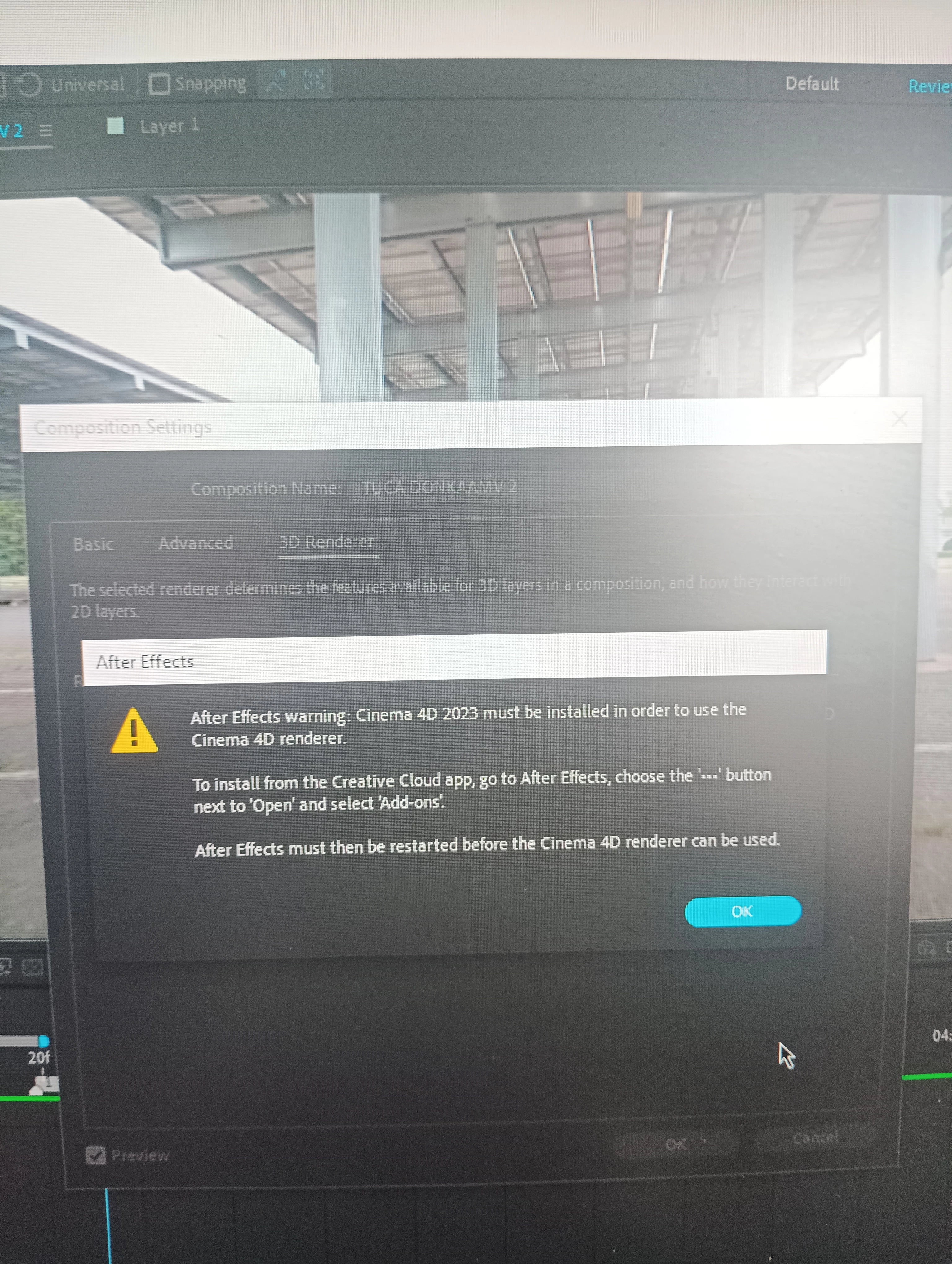

I'm facing Render by cinema 4d in After Effects...The geometry options isn't enabling in After Effects... When I've change the render in cinema 4d the after showing the message attached below 👇

Same problem here, I deinstalled C4D R25 after installing AE, because I have C4D 2023 installed!
Ther should be an option to give AE the installation path of C4D 2023 instead of R25.
Rameez_Khan
November 5, 2022
As I mentioned above, that will result in certain stability issues. We're working closely with Maxon to improve the experience in a future release.
-Rameez

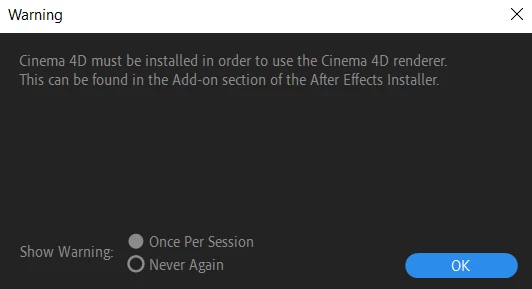

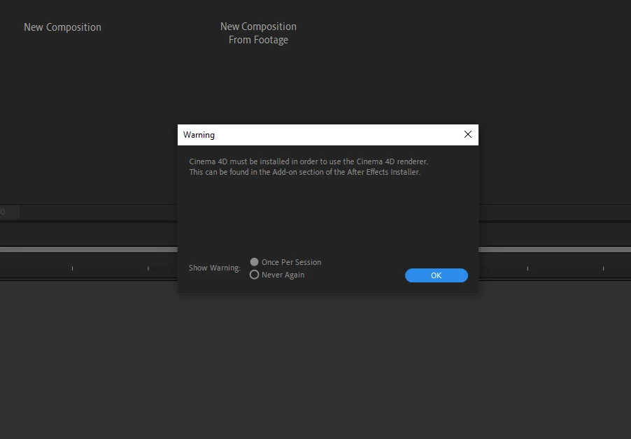

I have updated to the latest AE vesion with Cinema 4d addon, but when I open a project it shows a warning "Cinema 4d must be installed in order to use Cinema 4d renderer". When I check the addon in creative cloud, cinema 4d addon was installed.

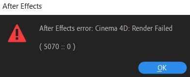

But still it's showing the warning and when I try to preview it it shows an error "Cinema 4D: Render Failed 5070 ::0".
Anyone have a solution to fix this issue?

Of course, as soon as I made this post the problem I was talking about magically fixed itself and I had the option to uninstall After Effects. I saw there was an "add-on" button, so I looked at it and it says Cinema 4D was already installed, so I opened After Effects to see if my laptop just wants to make a fool out of me by fixing everything as soon as I make a desperate plea for help, but no, it's telling me I need to install Cinema 4D. Not sure how to do that since it says I have it in the creative cloud. My less-than-amataur guess is that it installed somewhere on my laptop instead of the external hard drive, but I can't find it anywhere.

Hi Rameez @Rameez_Khan ,
I did check the install add-on box on install since I regularly use the C4D AE renderer.
23.0 is only version of AE I have installed. I have not installed a separate C4D or Maxon application. Anything I have for C4D on this machine would have been installed/uninstalled through the Creative Cloud App installer.

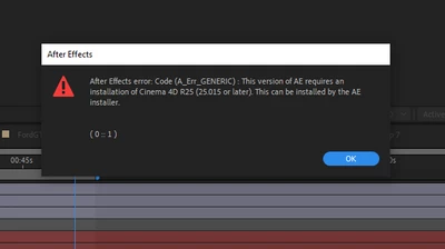

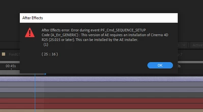

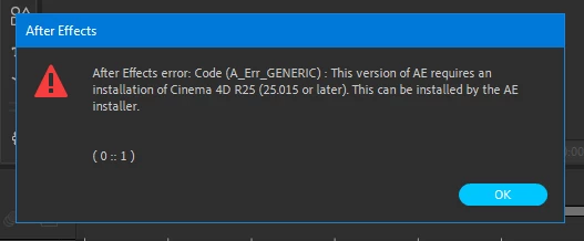

This is the error I get when I try to create a new C4D file.
This is what appears when I try to add a cineware effect.
Another error message that comes when I try to play a preview.
This project was created in AE 22.3 before updating. There seemed to be an issue converting the original file upon opening in 23.0. The error said something like "failed to copy file".
Hope that helps!
Ryan
