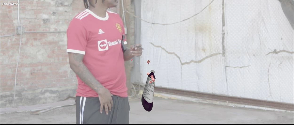

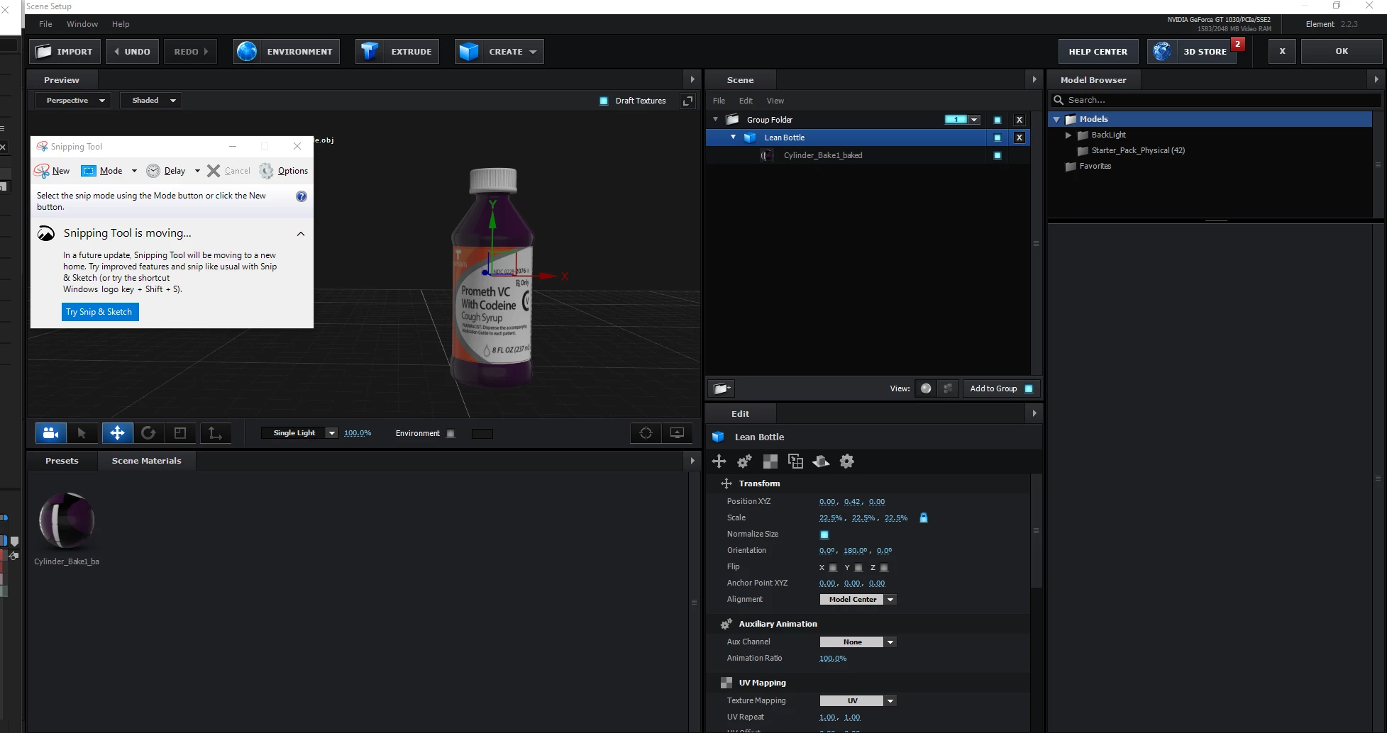

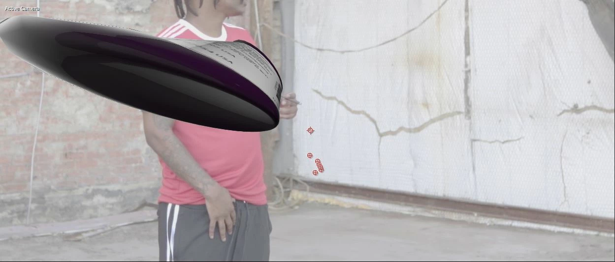

Hey guys i recently bought this obj from cgtrader for a music video, when i imported into E3d it notified me the texture was to big and would be downscaling it and it looks fine in Element but when trying to manipulate it in after affect the the controls like x,y rotation cause it to stetch shown below.
I have tried changing the anchor point but to no avail has is worked any tips or tricks would be greatly appreciated

It looks like the background footage was shot with a medium wide to normal lens. Double-click the Camera layer, and choose 50mm or 35 mm from the presets. Close the Camera Options. Go back to the Main comp and roll down the Transform properties, and hit Reset. You should now be able to manipulate the camera or the Element object without the distortion you are getting.

Nothing wrong. You simply created a camera with an extremly short lense. Check the relevant settings on the camera layer.
