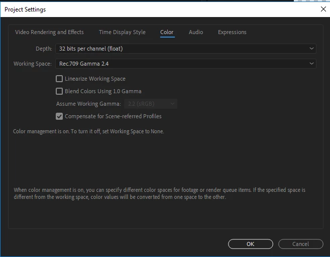

    1) You need to set a Working Space for color on your system. You do this in the Project Settings window.

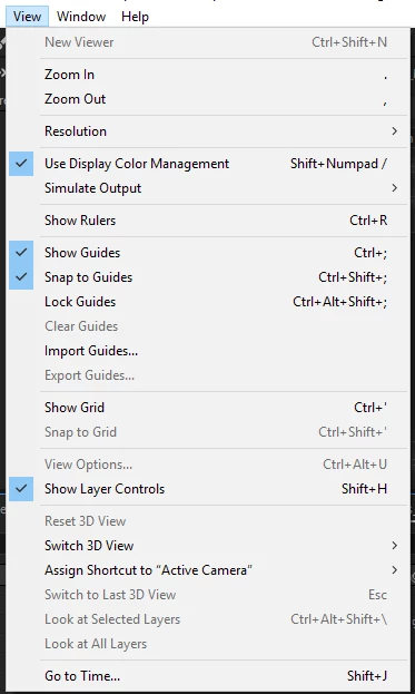

    2) Once you've set a Working Space for color, you'll want to enable Color Display Management. The setting for this is within the View Menu -

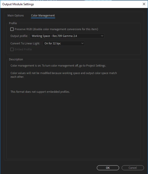

    3) When rendering, in the Output Module dialog, specifically the Output Profile, set it according to your target device -
    Rec709 Gamma 2.4 is the flavor of choice for digital output today - this may change in the future.

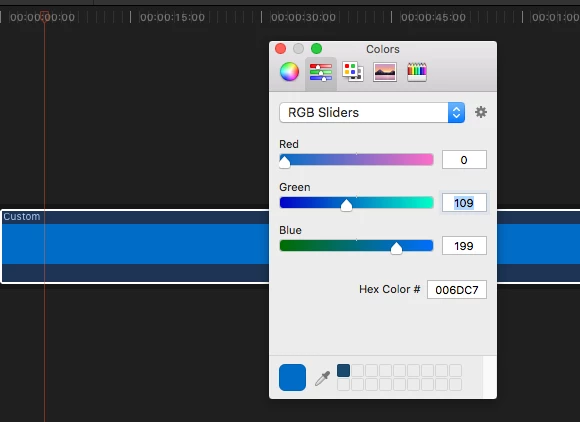

    First, you'll see that in Final Cut, I'm creating a blue solid with RGB of 0, 109 and 199 #006DC7.  I will stay consistent with this throughout this entire process:

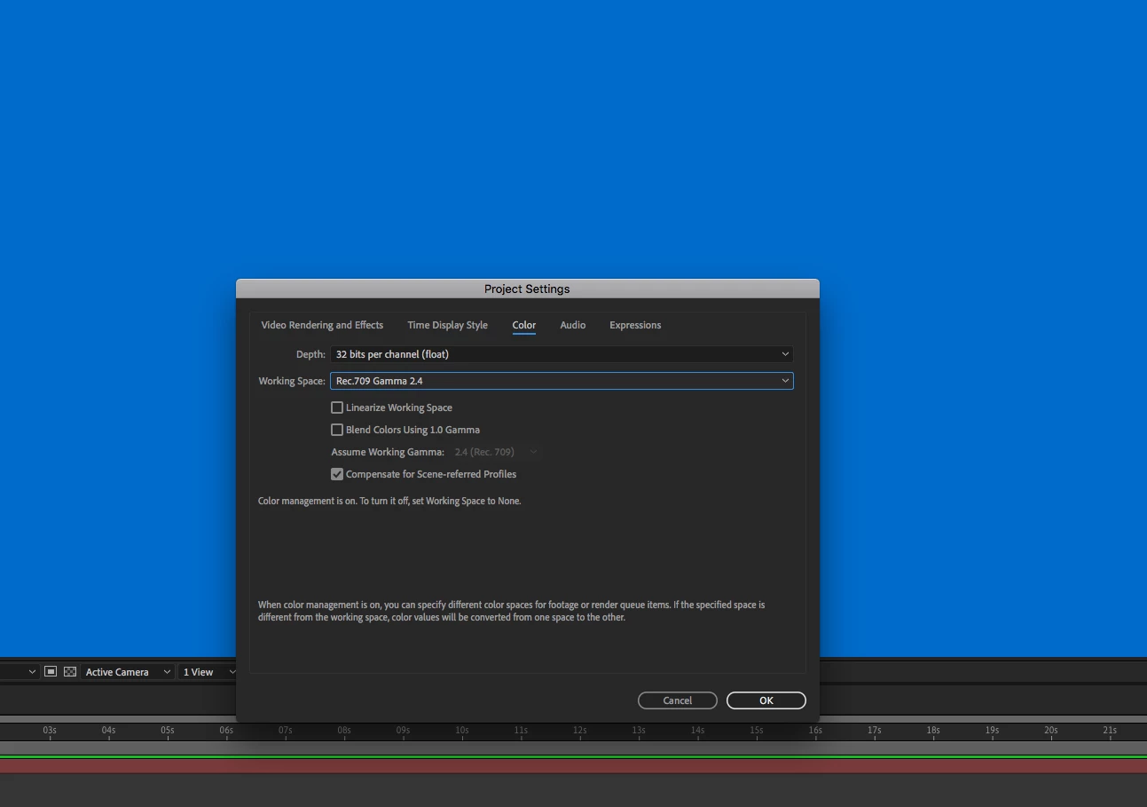

    You'll see here that I'm taking your lead on the project settings and selecting Rec 709 Gamma 2.4:
    "Use Display Color Management" was already checked by default:

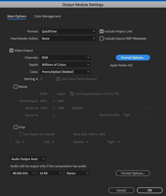

    You'll see that I'm replicating your settings under output module color settings as well:
    For more info, here's my render settings.  It's almost entirely default except I'm changing animation codec to Prores 422 (I've also tried Animation and Prores 4444, but it doesn't make a difference for the purpose of this color problem I'm experiencing):

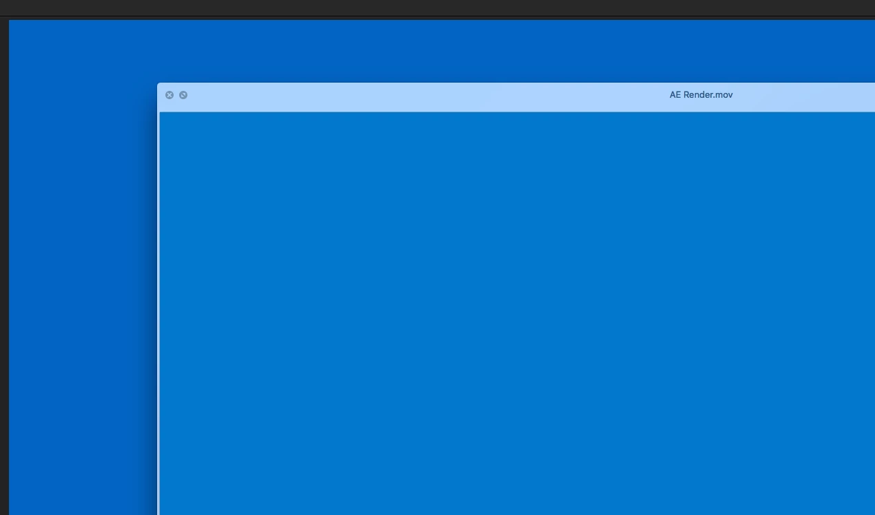

    You'll see right away that my rendered .mov file is noticeably a lighter color than what appears to me in the After Effects viewer window.  This is an issue I've seen several people complain about in threads like this.  Some suggest this is a QuickTime issue and that if it's opened within VLC, the colors will appear accurate, but as you'll see below - this isn't a solution.

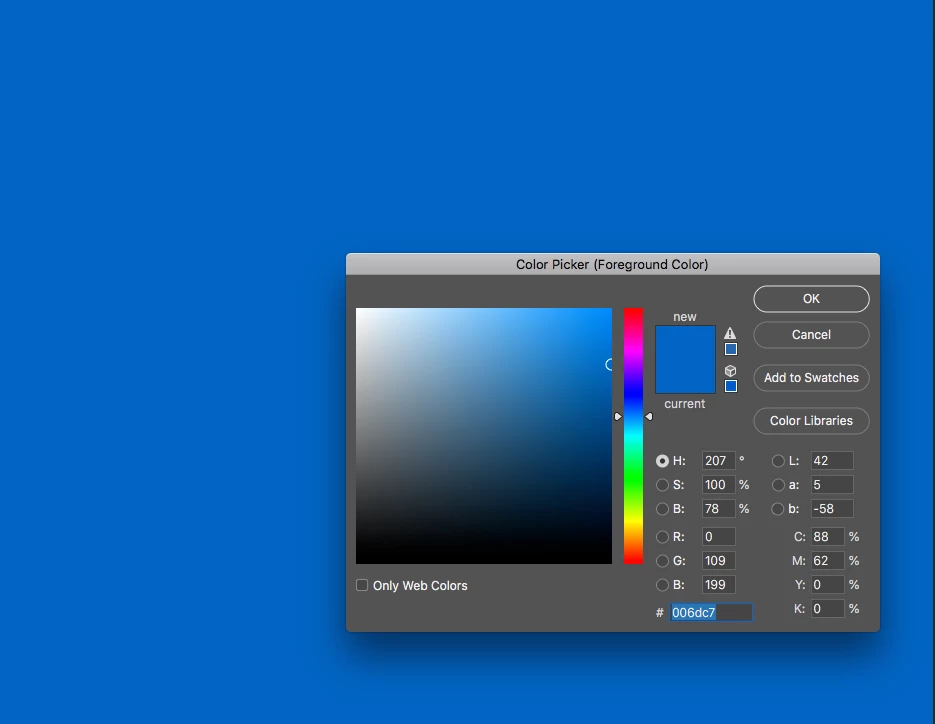

    I'll now go into Photoshop and create a new project with Rec 709 Gamma 2.4 for Color Profile:

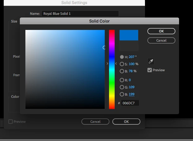

    Once again, I'm creating a solid with the exact same colors within Photoshop:

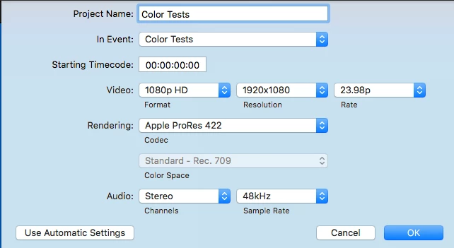

    Likewise, I'm going to do the same thing within Final Cut X (yes, I know most people here use Premiere, but stick with me on this).  Within Final Cut I have color space set as Rec 709:
    I'll create a blue solid in Final Cut with the exact same RGB/hex:

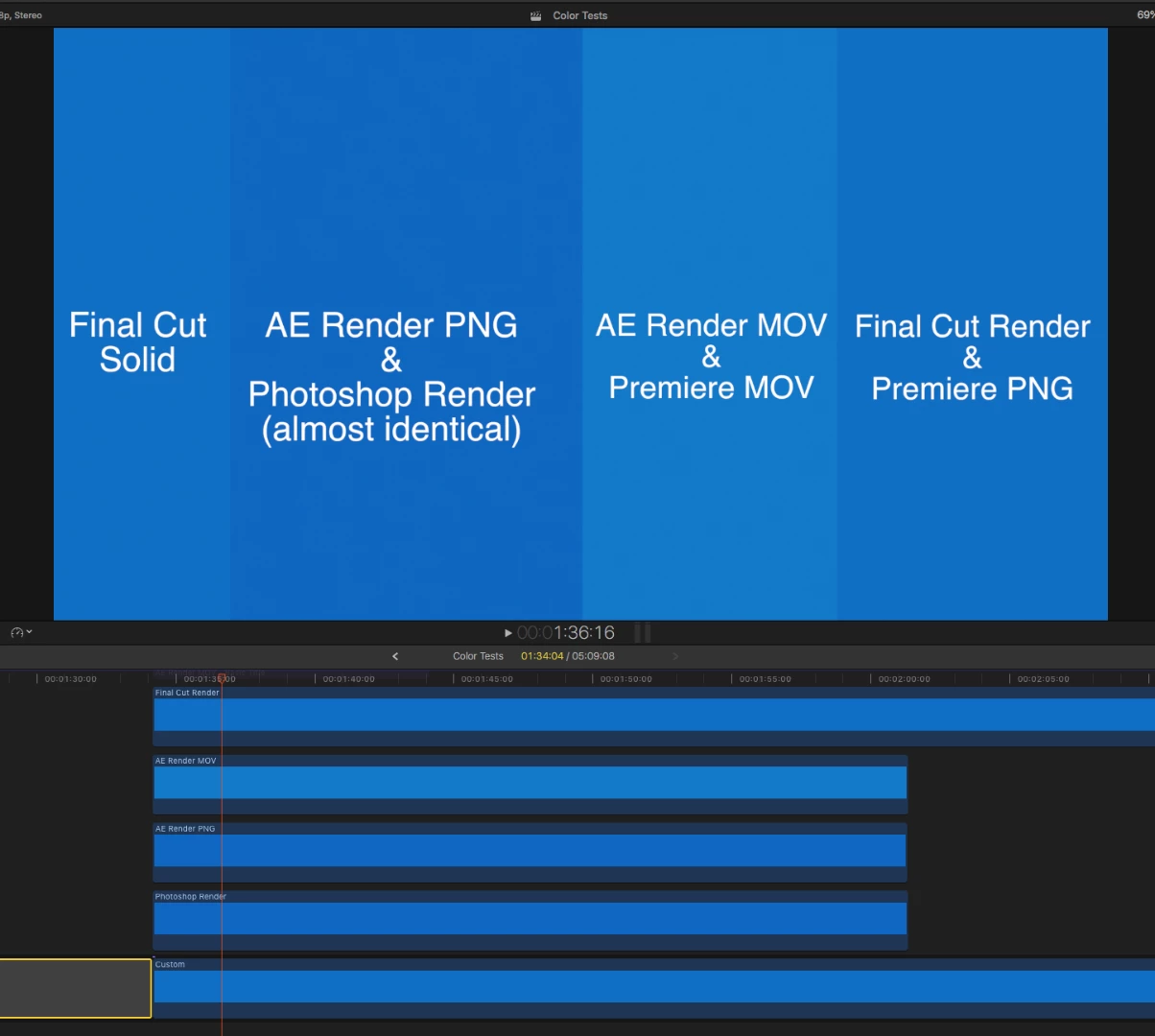

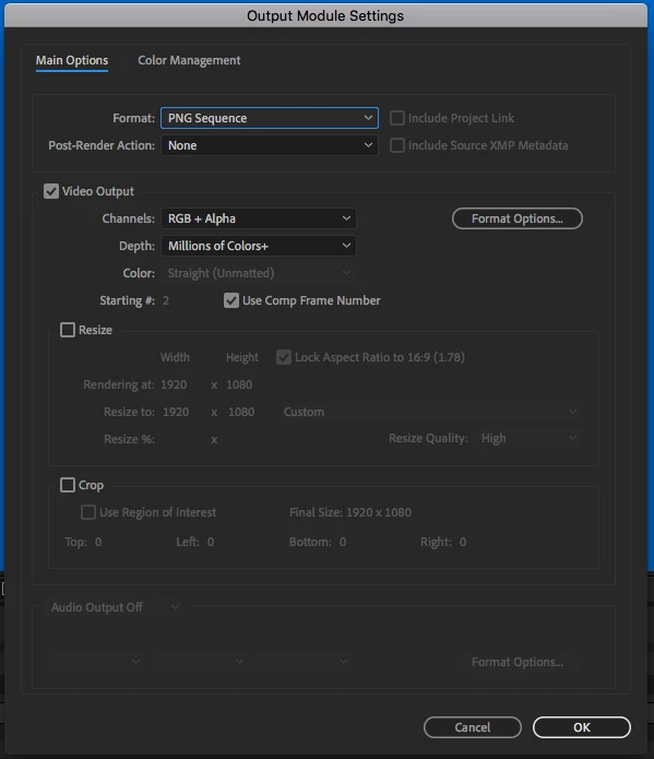

    One last thing... I'll also go back into After Effects and instead of rendering out a .mov I'll render out a still frame as a PNG.a lot
    For fun, I'll also go into Adobe Premiere, create an identical blue solid, and render out both a .png and a .mov...
    Within Final Cut, I layer all of these rendered files on top of one another and you can see the various shades of blue:
    You'll notice that the solid within Final Cut, any renders out of Final Cut (either as png or a mov), as well as the PNG I rendered out of Premiere are essentially identical.
    You'll notice that the PNG I rendered out of After Effects and the PNG I rendered out of Photoshop are almost identical... though these differ from what I am getting out of Final Cut and the Premiere PNG.
    The biggest issue, and the issue I'm trying to find a resolution to... is that the .mov I render out of either After Effects or Premiere, while identical to each other, are noticeably a lighter hue of blue than what I'd expect to see.  This causes me problems in my workflow, because unfortunately at the company I work for, they are using Final Cut for the final edits, but every .mov I'm rendering out of After Effects ends up with desaturated/washed out colors.   One potential work-around may be to render out of After Effects as a PNG sequence - though these still will not perfectly match with what I'm seeing in Final Cut, it at least will not be the desaturated/washed out colors I'm seeing by rendering out a QuickTime file.
