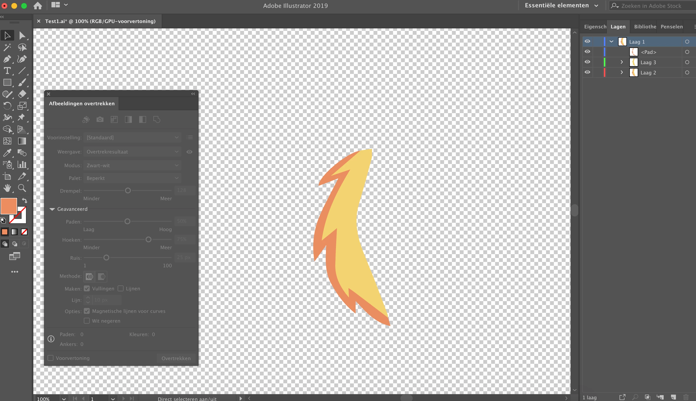

I am making animated stickers in AE using the Bodymovin extention.
For creating vectors I use Illustrator. Below you an example of a vector I made in AI and want to import in AE.

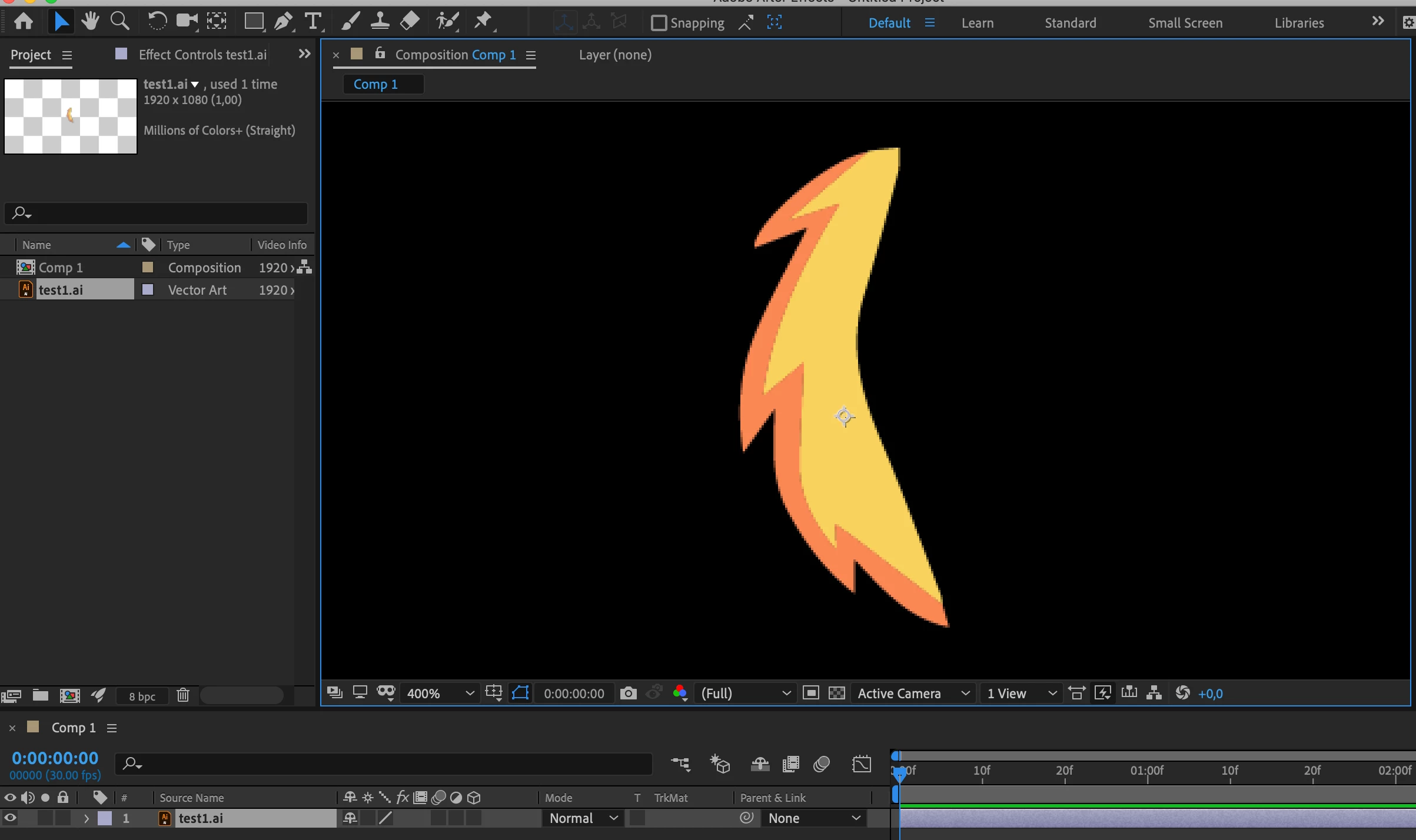

But when I save the vector as AI and import it in AE a very light transparency border is added around every different colored object. It sort of separates both parts of the vector.

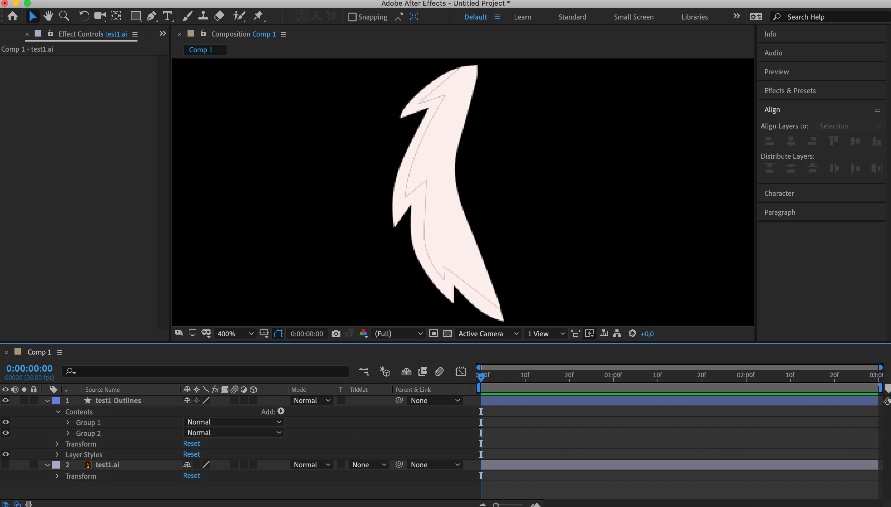

In the image below I changed the color to white so you can see the border (the black background makes the border visible). It should be one object like it shows in Illustrator. I also need to convert the file to a vector shape (because Bodymovin only works with these shape layers) and this only makes it worse.

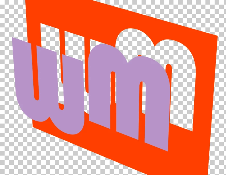

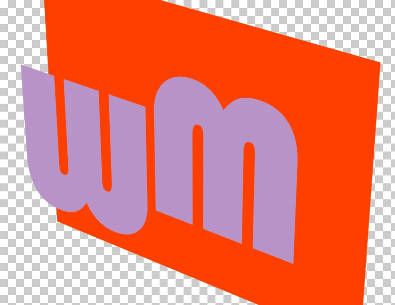

    If you design your vectors such that they overlap rather than cut out, you should be good to go.
    So like this...
    Instead of this...
