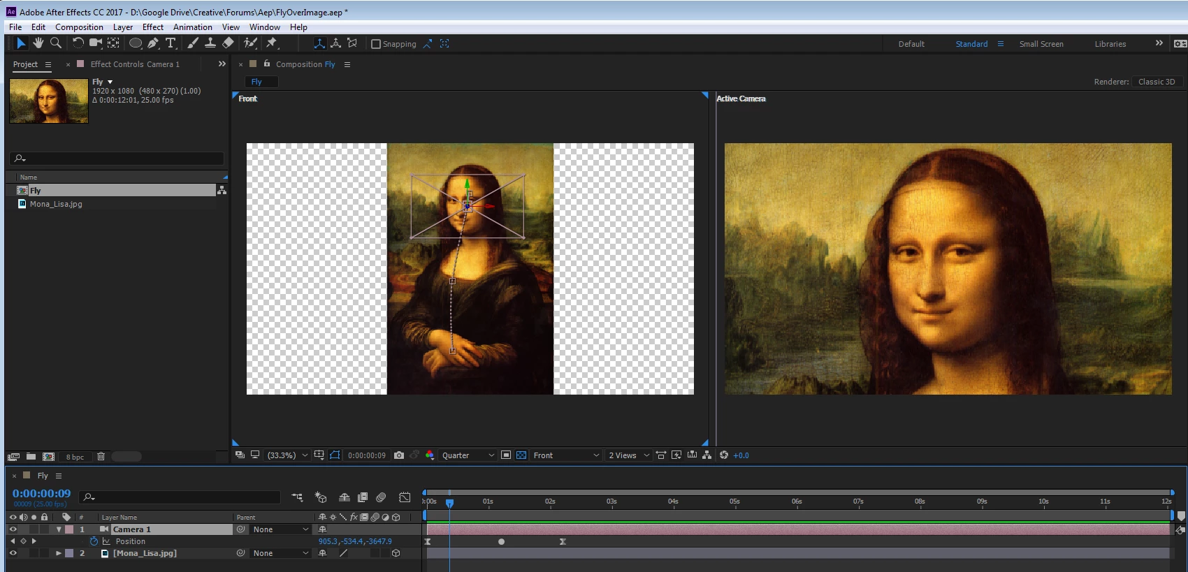

    what you want to do is called "motion control". when it comes to fly over high resolution images, I always recommend working in 3D and not the typical position+scale setup. I would recommend setting up your project this way:
    1. set you layer as a 3D layer by toggling the 3D switch for the layer
    2. create a virtual camera (layer->new->camera), set it to be one node camera, 50mm preset, make sure DOF is off.
    3. choose 2 views setup in the composition window. one set to "active camera" and the other set to "front"
    4. click on the front view windows and choose view->look at all layers so all your layer will be visible in the scene.
    this is how it's supposed to look:
    5. use the position of the camera to create your movements.
    by setting up your project this way, you get full control over how your motion path is interpolated because you see the whole view, and you can use the bezier handles to change the spatial path as you wish. for the temporal keyframes you can use auto bezier keyframes or the graph editor. now you just need to practice manipulating keyframes and movement correctly...

    It's really easy to turn a vector path into a motion path. Here's the steps.
    1. Use the pen tool to draw a path or copy a path in Illustrator, click anywhere in the frame with the pen tool and paste
    2. Press Alt/Option + m to set a mask path keyframe
    3. Ctrl/Cmnd + c to copy
    4. Add a null to the comp
    5. Press Alt/Option + P to add a position keyframe
    6. Ctrl/Cmnd + V to paste
    You'll get rove over time keyframes. You can grab the last keyframe and drag to adjust the timing. EZ as pie.
    Now you can parent the null to the camera (see the video below) or you can use an expression generated by simply dragging from the Camera Point Of Interest (a), to the position property of the null. These are really basic AE animation skills. If you want you can also leave the camera stationary and parent the image to the null and it will move. You then just adjust the position of the image to frame it ip for the start and end position. The advantage of using the pen tool to create your move is that you can draw the path directly on the image and as long as the image is at the default position, rotation and scale, the move will perfectly match the path.
