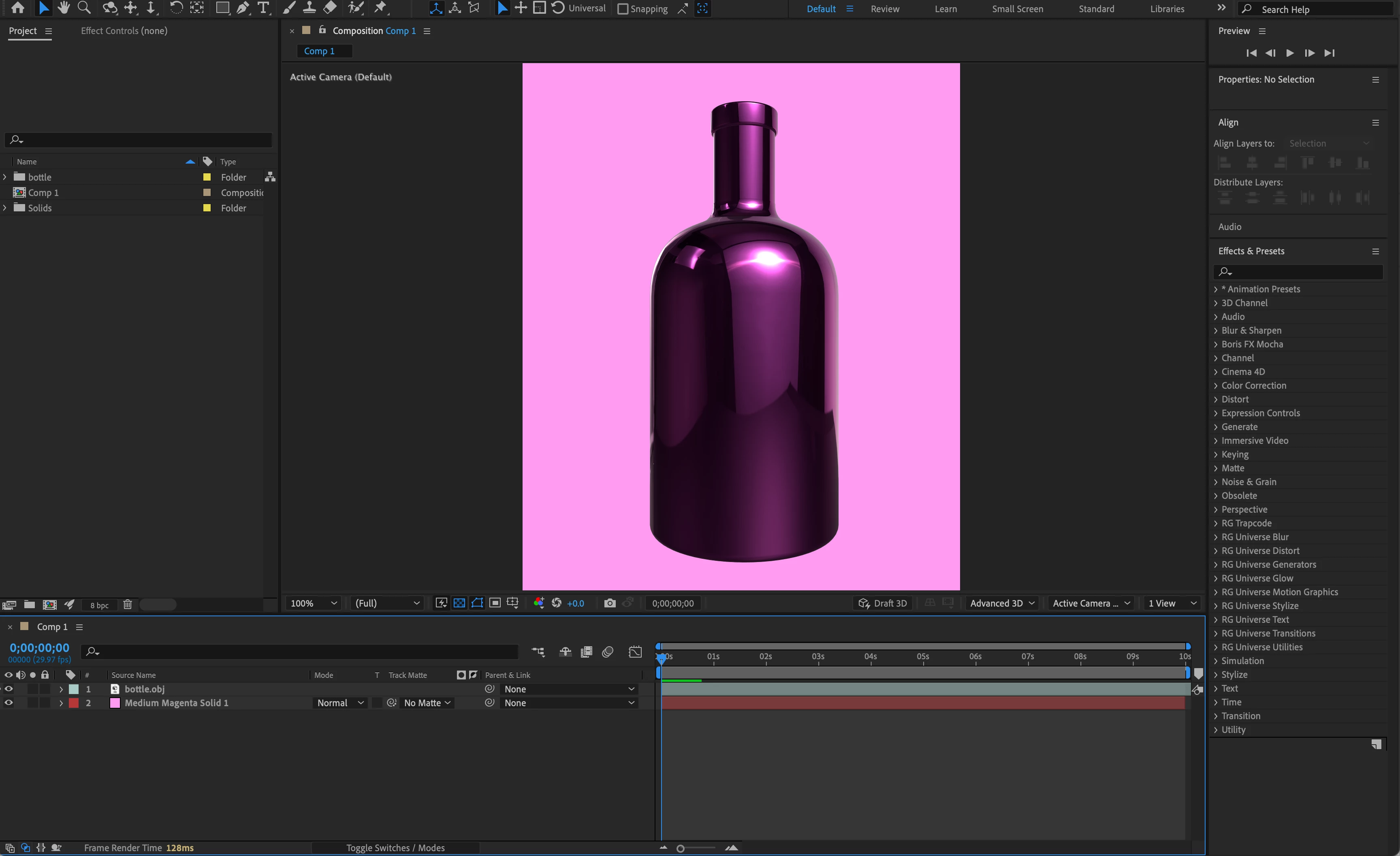

Hello, I've imported an OBJ model from Dimension. The light has an image source that isn't from Dimension, and because the material of the model is meant to be super reflective, the image source is affecting its appearance.
I'd like to remove/replace the image, to have greater control, but I have no idea where this lives.

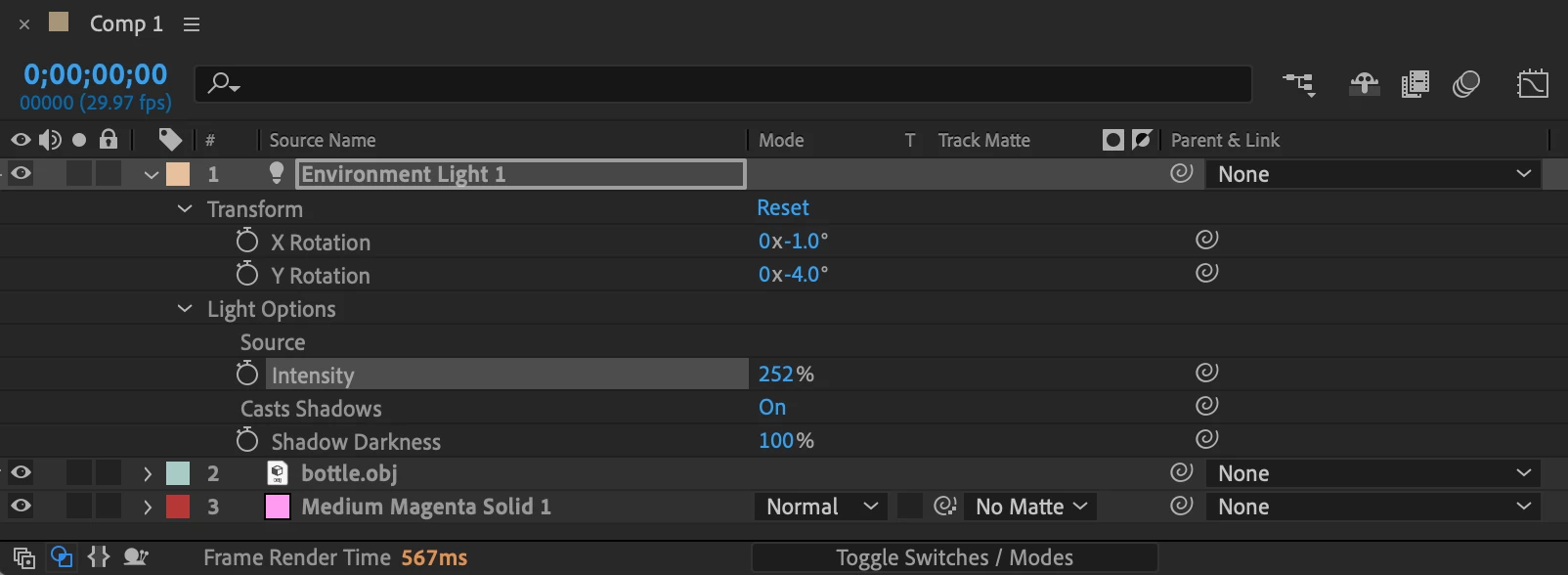

I've added an Environment Light which allows me to edit the light's Intensity etc., but the source itself is not available. Layer > Light is also greyed out.

You need a specific Environment light image layer and an Environment Light that points to that layer. You only have the Environment Light layer and the background solid in your comp. You'll need to add another layer.

You can add an HDR image as a Source in the environment light. That will replace the default image in the reflection.
Hope it helps.
