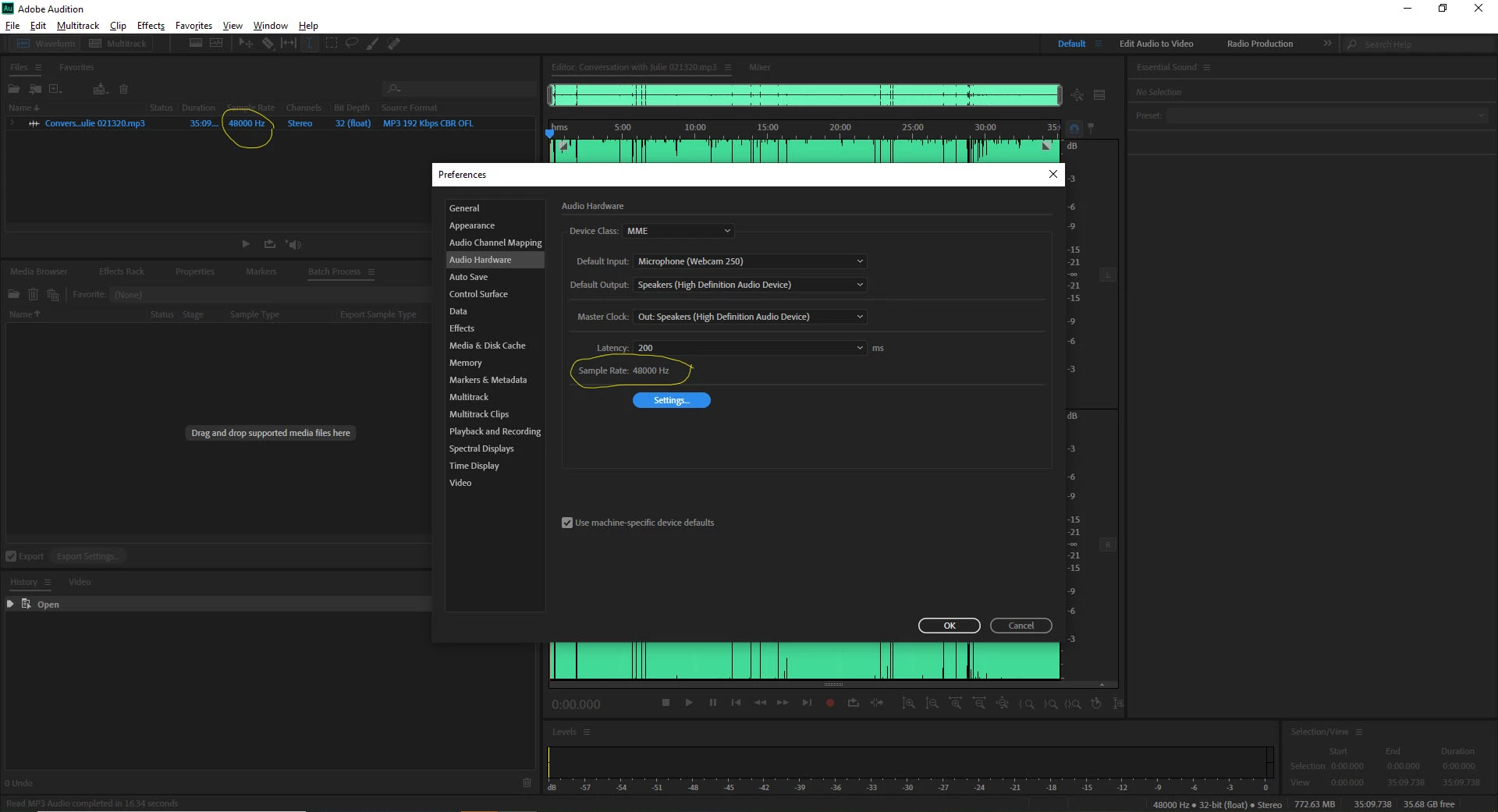

Have to ask some questions: Firstly, what was the sample rate of the original recording set to? Secondly, what's the default sample rate set to on your sound device? One thing that might help is a screen-grab of your Audio Hardware settings in Preferences.

The Sample rate appears to be at 48000 hz also opening up the audio hardware it seems to be set to 48000 as well. I have uploaded a photo/screenshot as well.
Ive done this before in the past couple days for about that amount of time and it had no issues. Just happened on the one I did today.
