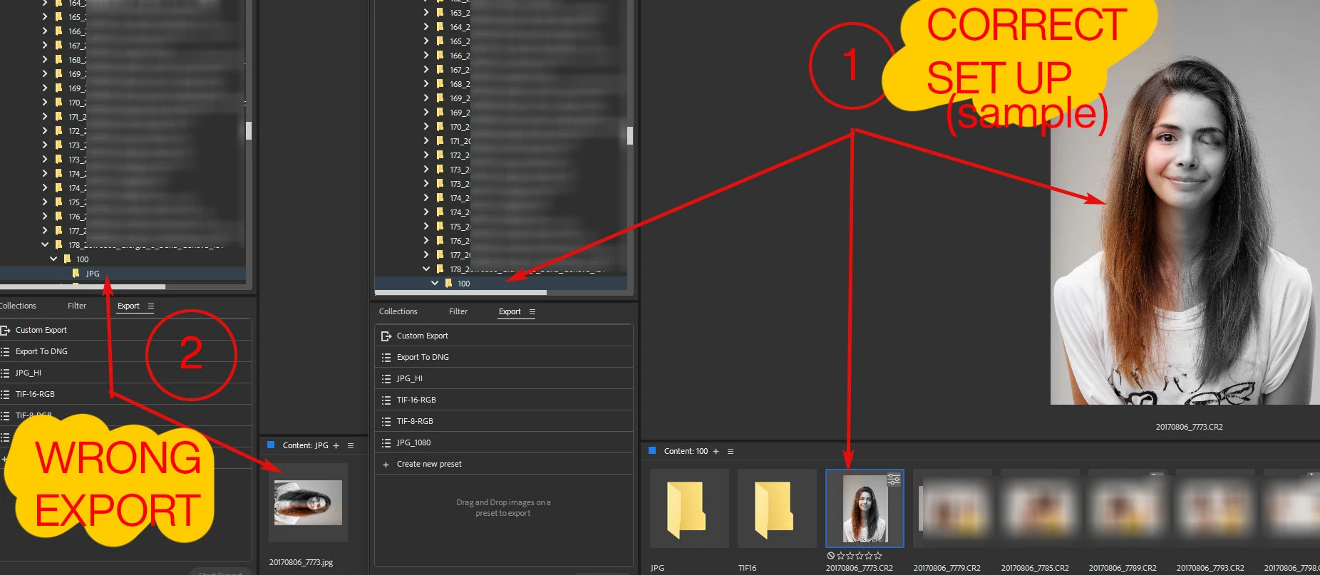

Hallo! The following n.1 problem is present either in the current (non beta) version of Adobe Bridge or in the 14.0.0.57 beta.
#.1
When using the "C" tool (crop, etc.) in ACR on a raw file to do horizontal or vertical flips, unexpected results such as unwanted rotation or, more simply, the final rendered result is NOT mirrored in the required way when exporting.
On the other hand, using the export inside camera raw everything works correctly according to the possibilities offered by this tool, which are not necessarily the same as the export tool nor the workflow tool.
Consistency of results would be desirable.
I was able to do this test immediately to experiment with the expected new possibility of using the optional jpg/jpeg extension, so I took the opportunity right away to do this test as well, and I confirm: both in "old" (current) Adobe and in the newly released beta (14.0.0.57) the problem is present. Beyond that, there are likely problems in the metadata consistent with this, because even if I run a rotation of the wrong result in Bridge to correct, then dragging in other programs results in the files being rotated in unexpected ways.
So: in addition to solving problem #1 , it would be best to consider the same set of possible (and correct) exports obtainable from both INSIDE PHOTOSHOP and with ACR as well on #2 EXPORT and #3 WORKFLOW
It is really strange and curious that, for example, an export of PNG or TIF with transparency works somewhere and somewhere else does not. I think it should be someone's right care to make his own checklist to whoever is in charge of doing the saving part, cross-referencing these tools 🙂
