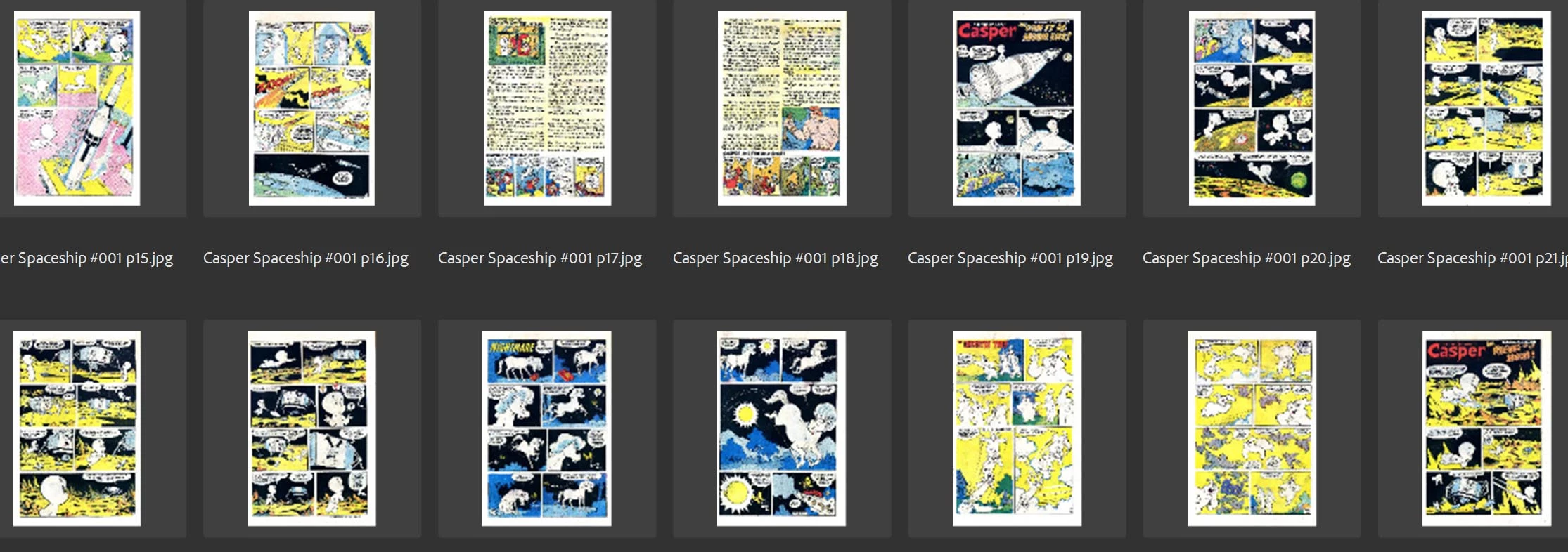

I was using the previous version of Bridge today without any problems, however, after updating to the latest version, all the thumbnails look very blurry.
I tried changing the thumbnail preview quality options to high quality, but this did not change the quality of the thumbnails.
If I use the thumbnail zoom slider and enlarge the thumbnails to a much bigger size, then they display at the correct resolution. Also, when I open Bridge, and the thumbnails load, for a split second they are sharp, but then revert to the blurry quality.  😞
I have attached an image of the blurry thumbnails.

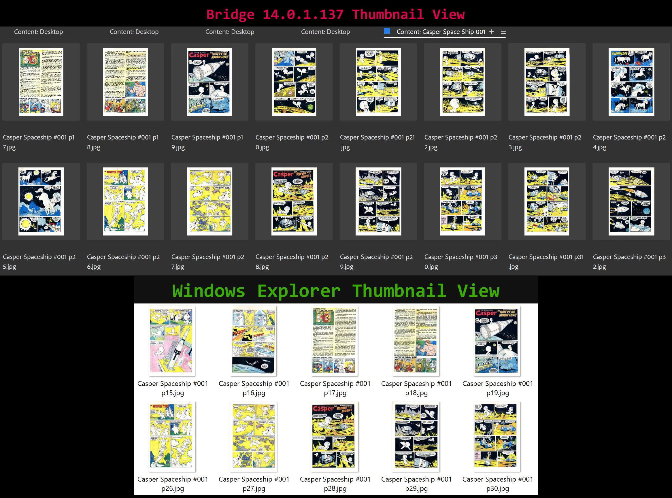

With reference to your question above, I deleted the latest version of Bridge, rebooted the computer, then re-installed the older version (14.0.1.137) and was horrified that the image degradation was also visible there as well. Whereas prior to the installation of the latest version, on the same day, 14.0.1.137 was not showing any problems. Since then, it doesn't look as bad as previously, but still not 100%.
I have attached a screen grab of my current re-installation of 14.0.1.137, vis-à-vis how they look in Windows Explorer Thumbnail view. When you magnify the image, the Windows Explorer version does appear to be of a better quality.

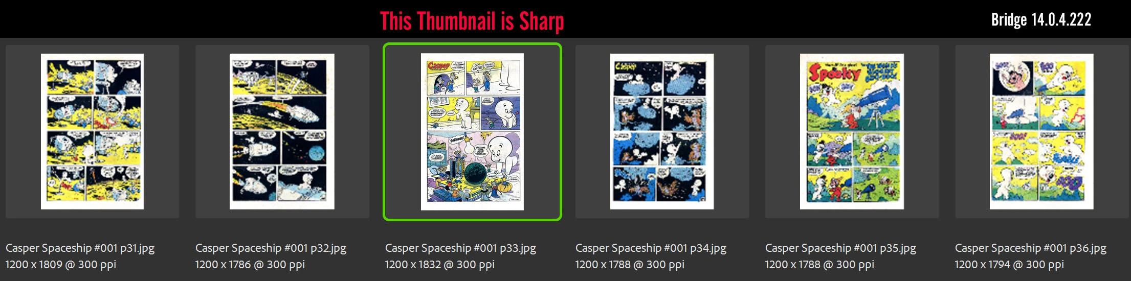

I just updated to Bridge 14.0.4.222 and the problem persists, albeit with a slight improvement: When I open the latest version of Bridge, one or two random thumbnails will display correctly (sharp definition), while all the others remain blurry. Clicking on the sharp thumbnails will cause them to become blurry as well.
I tried clearing the cache, but this did not help. Please see the attached screen grab to see what I mean.
