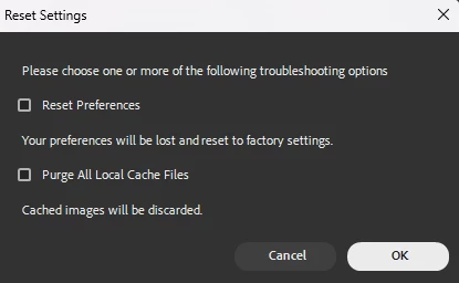

First, try to reset Adobe Bridge:
  • Press Ctrl+Alt+Shift (Windows) when lanching Adobe Bridge until the Reset Settings dialog box appears.
  • Select all three options--Reset Preferences, Reset Standard Workspaces, and Purge Entire Thumbnail Cache--and then click OK.

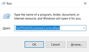

If this does not help, try this on Windows: GPU info & Logs location is %APPDATA%\Adobe\CameraRaw. A shortcut to get to this folder on Windows is:
  • Press the Windows + R
  • Enter %APPDATA%\Adobe\CameraRaw
  • Rename the GPU & Logs folder in this directory by adding .old at the end. (GPU.old & Logs.old)
  • Restart Bridge, which should capture the updated driver & hardware capabilities.
Let me know if this helps. Thanks!

Hi Sameer,
Unfortunately, neither option fixed the problem. I did also notice that when I tried to reset Bridge I only got 2 options compared to the three you said I would get:
Thanks!
