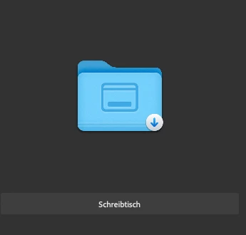

After installing Bridge Beta (14.0.0.57) and disabled Bridge to open Camera Raws directly it works pretty well. I think there is a conflict when opening the raw files directly with Bridge, don`t know why. The only problem at the moment, Bridge does not show desktop files, there is a blue down arrow attached on the folder. Any ideas how to solve that?

.The only problem at the moment, Bridge does not show desktop files, there is a blue down arrow attached on the folder.
Could you share a screenshot or video of the issue with us? This will help us investigate further.

.. I found a solution here in the community, its only a rights management problem on mac: https://community.adobe.com/t5/bridge-discussions/adobe-bridge-cannot-access-desktop-on-imac/td-p/13135493
Thanks to @gary_sc who discribed it there. Solved! The attached screenshot shows how it looks.

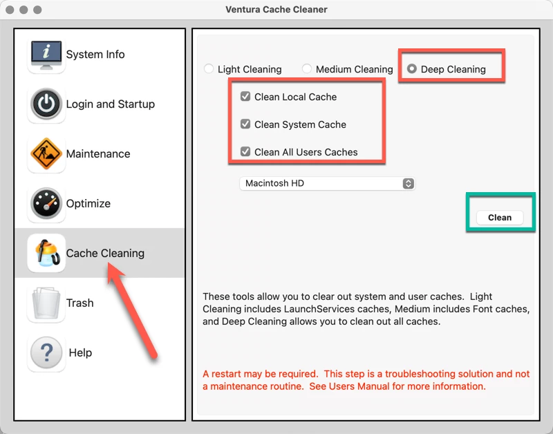

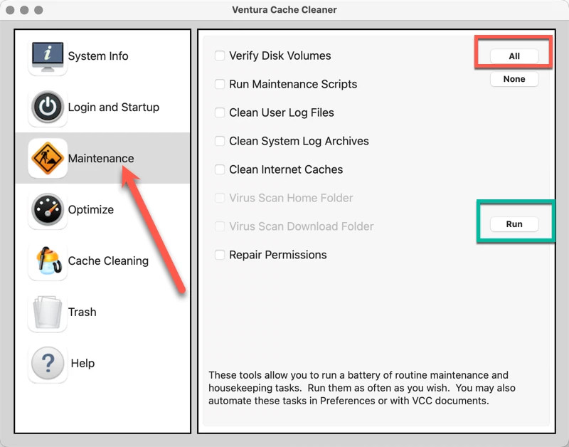

Here are some instructions if you choose to try this:
Please go to https://www.northernsoftworks.com/ and download Ventura Cache Cleaner. You can use this for ten days as a free test. (Until you pay for the software and get your user code, you will have to wait about 10 seconds before using the software at full capability.)
After starting the software, go to the Maintenance tab, click "All," then click "Run."
You may be asked to reboot your computer at this point; it varies.
Now select the Cache Cleaning tab. Select Deep Cleaning, check all three Caches to clean, and then click "Run." You'll probably be asked to verify which cleaning you want and say yes to all as they show up. You will be asked to Restart your computer, and you may be told something went wrong, and you need to restart and run this process again.
I CANNOT say that this will fix this issue. Actually, I doubt it, but it's worth a try (and I'm curious if it will work or not). At a minimum, it will only take a bit of your time.
