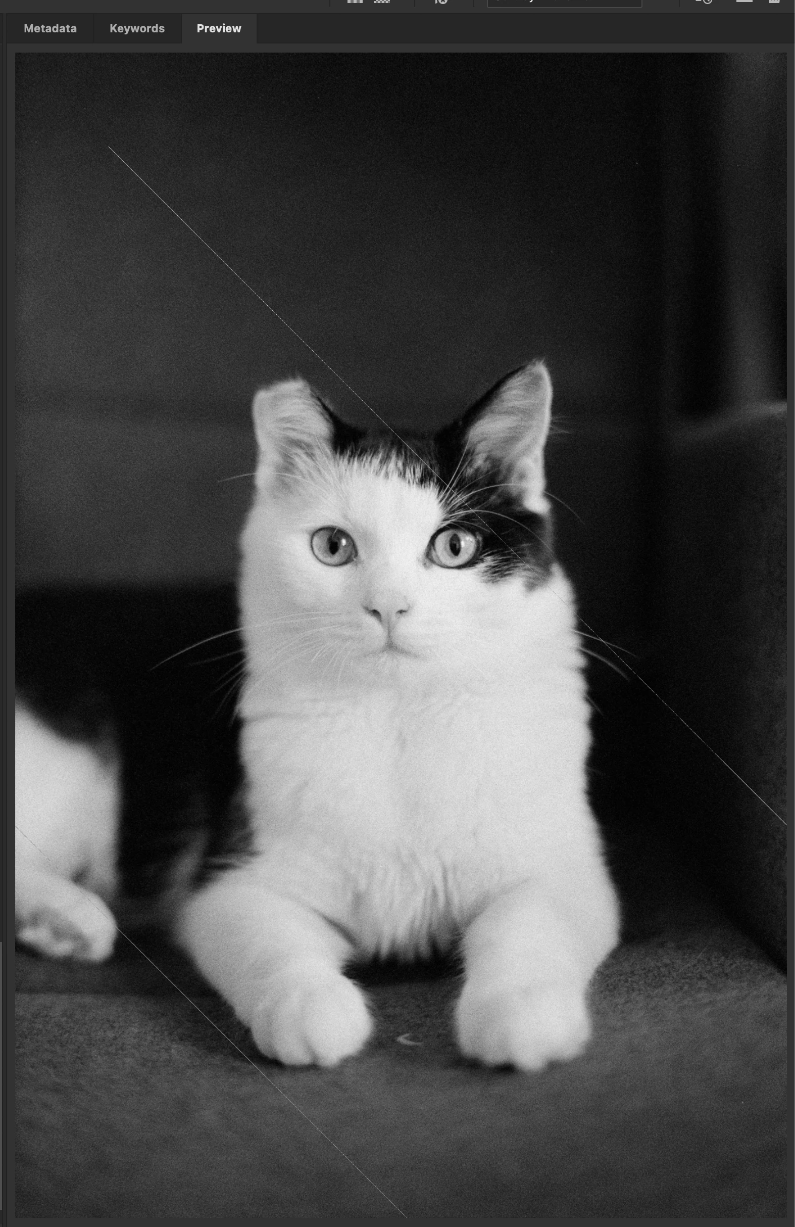

Diagonal lines in Preview and Export
Can someone please help me understand why I am getting these diagonal white lines when previewing my PSD file and also in the resulting JPEG export? It is quite annoying and I just can not figure out why. It only shows up on some images, not all, and I can't find a pattern to it.
I've attached the PSD too, in case that helps. I am running Adobe Bridge 12.0.0.234

Hi Gabriel,
OK, this was a great way to send me the image, it/they came in fine.
First, the problem shows up in Bridge on my computer. This means it's probably not your system. However, it does NOT show up when I open it in PS. I'm not sure you mentioned that it was or was not showing up in PS. This is a bit of an inconvenience as it does not give me much latitude to experiment and immediately see the results.
So, I did a few experiments: there is a key-combination (Shift-Option-Command-e) that will take all layers and make them into one layer on top of everything. Again, the line remains in Bridge, but does NOT show up in PS.
When I saved as a JPG, again, it does NOT shows up in Bridge and it does NOT notseen in PS.
Lastly, I save the image as a TIF image. And finally it does NOT show up in Bridge and does NOT show up in PS.
You also did not mention if you've printed this or not, but if you have, does it show up there?
Two last experiments: I saved out JUST the positive and then JUST the negative of the cat (none of the other layers) and the line shows in both. So there's nothing that the adjustment layers are adding here. But, when I saved each as a TIF image, no line in either version.
Lastly, about this negative: the bottom layer is a negative of the image. Were these scanned? If so, how did you scan them? What kind of scanner, and what resolution were they scanned at? What kind of software was used to do the scanning? Or, did you photograph a negative? If so, what was your process?
Overall, despite the annoyance of this whole thing, and unless the line shows up when you print, I'd not be overly concerned.
Looking for your comments and answers to my questions here.
Gabriel Asz.
Feb 13, 2022 7:58 PM UTC
Thanks for doing all that! Indeed, it is the same for me. It looks fine in Photoshop. I did however not go as far as to testing individual layers. Thanks for confirming it wasn't the edits that caused it.
The scanning technique was indeed using a Canon DSLR, a film carrier, and using my iPhone as a back light running a "white screen" video from YouTube.
One thing I do notice, is that when I import all the RAW files into Photoshop at first, Adobe Camera Raw pops up, and some of the shots are rotated, so I have to rotate them inside ACR (using Cmd + ]) to make sure they are all aligned the same (so that I can later apply my negative conversion actions). I'd be curious if it's at that point where the issue happens.
I don't really have a positive outlook on this to be honest. I'll likely have to start converting them to JPEG using Photoshop. It'll be less convenient, but perhaps there is no better choice momentarily.

Feb 13, 2022 8:07 PM UTC
But do you see the line if you save as TIFF?

Hi Gabriel,
I think the best reason why no one has responded is because no one has a ready answer for you. I've seen vertical lines and horizontal lines, but diagonal? That's a new one for me. That notwithstanding, let me see if I can help parse things out.
First off, you supplied a screenshot of the image, but you did not provide the image. While the former is a big help in understanding what you're experiencing, it does not provide any mechanism to see if anyone else can get the same artifact on their system.
Please add some background information: What is your OS (and what release)?
You state that some of the images show this: is there any consistency of what images do show this? Do they only show it on the screen, or do they print with this line as well? Is the line always in the exact same place, or does the location drift? The screenshot shows this in a portrait mode image. Do they ever show up in a landscape view image?
What kind of camera was used? How were the images saved (jpg, tif, raw)?
I'm sorry for all of the questions, but like I said, this is new to me (and probably many others) so the more information we can get, the better chance we can get to the bottom of this.

Hi Gary!
Thanks for the reply. It's odd, I did attach the original PSD but for some reason it's not showing here. I'll add them to WeTransfer. I hope that's allowed: https://we.tl/t-RQsA2CVIr8. I've additionally included another PSD which doesn't have the issue, taken under the same condition and with almost identical edits. They were both taken with a Canon DSLR as raw files.
Also, BINGO! I think you've hit the nail on the head here Gary! They do seem to show up only on the shots with portrait orientation. I wonder why! Any ideas?
