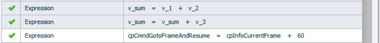

    To calculate in Captivate you need to use the Expression command. It has the four main mathematical operators.
    Some examples:
    Besides +, you have - * and /
    I added the last line to show that calculation can be powerful: that command will skip 60 frames (2 seconds if the default 30FPS is kept) on the timeline. Check out the end of this thread, where I took advantage of that type of workflows:
    https://community.adobe.com/t5/captivate-discussions/how-to-resume-audio-from-where-it-last-stopped/td-p/13478947
    You are showing only the logical operators for a condition. Bit amazed that you always ask for JS whereas you didn't yet explore the possibilities of the point-and-click actions in Captivate.

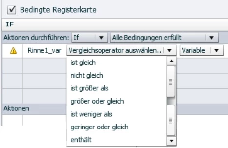

    Hi and thank you very much again for your help!
    How can I calculate with variables? Within the advanced actions, I only have these options (see screenshot):
    includes
    Maybe my Version 2019 (11.5.5.553) is not capable to do this?
