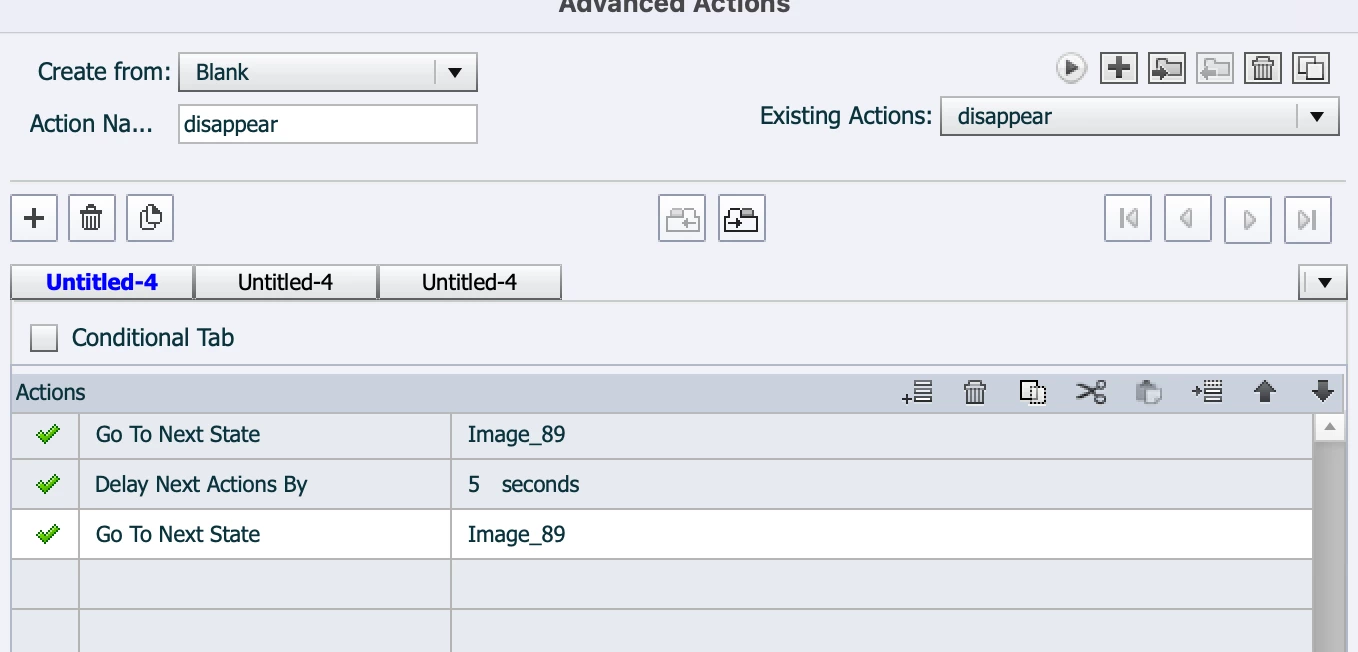

    Hi Lilybiri,
    I have setup the actions as you instructed. But I would like the large images to appear when the touch/mouse is over the small image and to immediately disappear when the mouse/touch is off the small image. The way I have it setup with the actions you suggest, the large image state stays onscreen. I have tried other ways, usuing the rollover image (which works on the desktop), but not on the mobile.
    ANy way to have the large image pop up only when the mouse/touch is on the small image? So that when the uses removes the mouse/touch, their is not a delay for the image to disappear.
    Maybe I am not doing the action correct, here is a screenshot of my actions.
    Appreciate your help to this point.

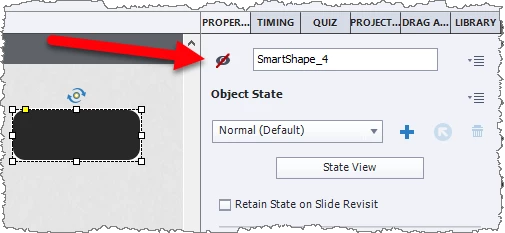

    The Rollover Slidelet object is SWF-based and is therefore not compatible with HTML5 output.
    Place your larger image on the same slide as the smaller image and set it's visibility to Not Visible in Output.  This is done via the small 'eye' icon on the image's Property tab.  Here's a screenshot of the same thing for a Shape.
    Next you make your smaller image to work as a button so that when it is clicked it will execute an Action to SHOW the larger image.
    For extra credits you need to then decide how you want to HIDE the larger image again.  Do you want it to Hide automatically after X number of seconds?  Or do you want the user to click the larger image to hide itself?  That's up to you.
