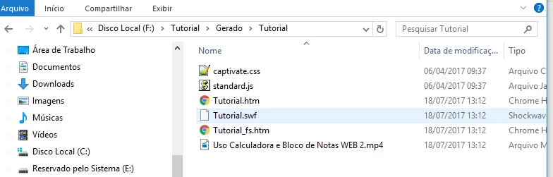

Hi Lilybiri! Its Works fine on Preview (F12). And I lauch using the Tutorial.htm, just like the image below:
July 18, 2017
Important to notice that when it publishes, adobe captivate generates the MP4 file with the content of the cpvc.So, it looks like to be some problem of the swf to execute mp4. I'm wondering..
