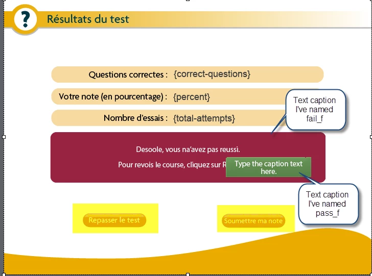

    I've changed the retake and continue buttons to image buttons, then added my custom success and failure captions which I've named 'fail_f' and 'pass_f':

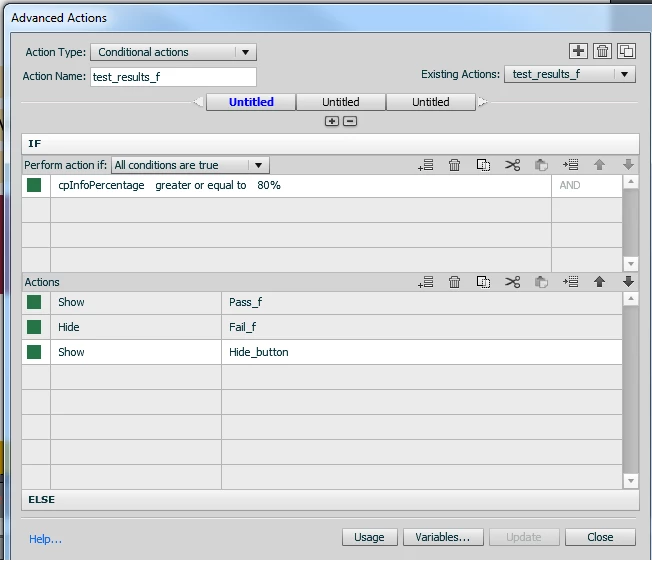

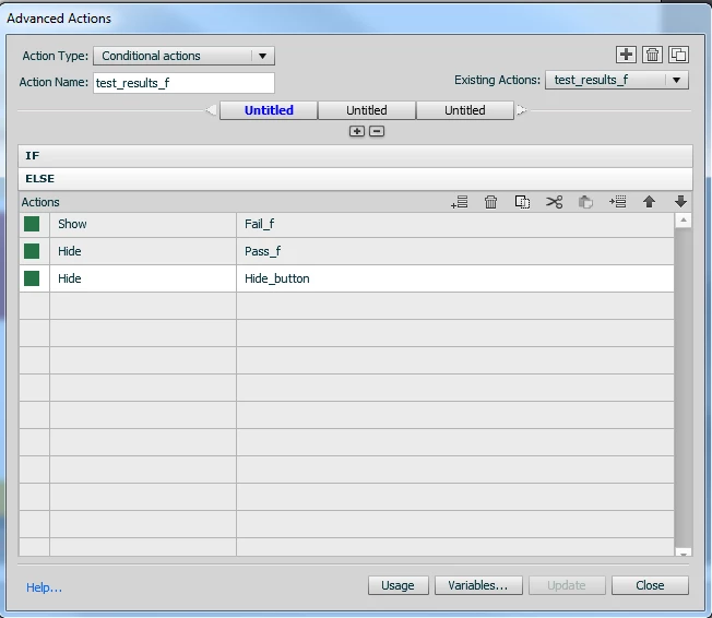

    And here is my advanced action on entering the quiz results slide:
    The hide-button, is a white rectangle that I added so that I could place it over the retake button if they passed the quiz successfully.

    Hi There,
    PLease use just 80 instead of 80% and then check if it is working fine.
