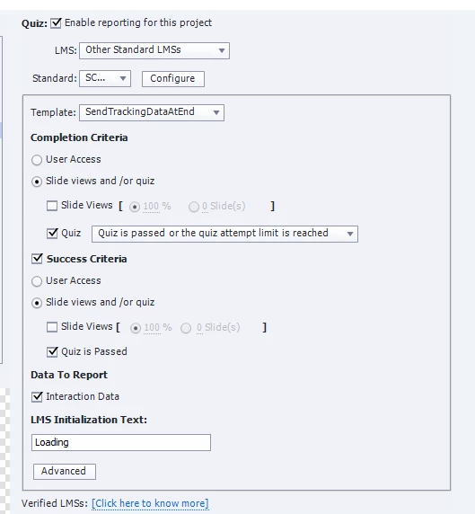

My question is: where is that button, and can I see the Advanced action in a screenshot (please use the Preview of the action).
I suppose you checked Advanced Interaction to see if the Total score is correct.
Can I also see the Reporting and the Settings under Quiz Preferences?

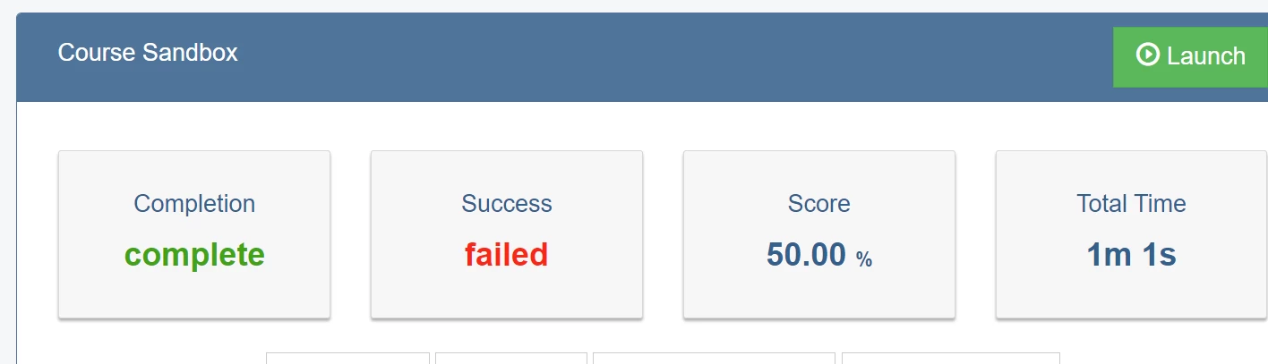

I am attempting to rebuild in a new blank course - think I am getting closer to making it work, but still struggling with the quiz results (seeing them reporting correctly in ScormCloud now but status still is not correct). Users have 3 chances to pass quiz. A pass gets them to an attestation button. 1 fail they get to retake quiz (retake button is there), 2 fails they have to retake course (jump to slide 1), 3 fails they get a you failed button.
I want to show status - incomplete/complete (so I know if user exhausted all 3 attempts) and then the quiz score. Scorm Cloud just crashed on me - so not sure if this last iteration worked.
Mar 17, 2023 4:18 PM UTC
and it looks like I had the luck of the Irish (St. Paddy's Day) or more likely having @Lilybiri looking at my work. The issue this time was an error 40 - 40 cm from screen. Believe I solved my issue. Thanks @Lilybiri and hope I didn't take up too much of your time. I appreciate all you give to this community and helping rookies like me 🙂
