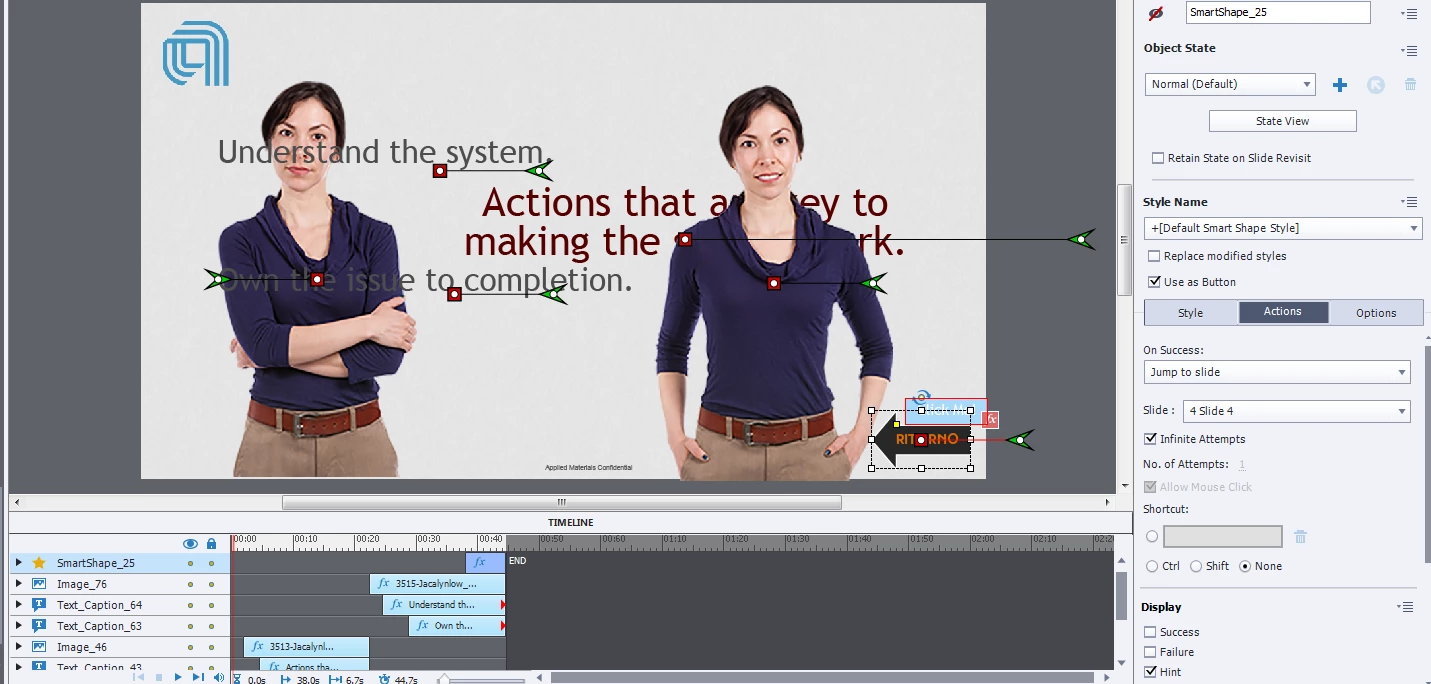

My lesson has three parts. I am using page controls so the user advances the lesson one page at a time.At the end of each section there is a shape labeled "return" that has action properties of "use as button" and on success: jump to slide, slide 4.
Slide 4 is a listing of the three chapters. There titles for chapter two and three are transparent buttons, that, on success: jump to slide X.
The idea is that the viewer is enabled to do some basic navigation, maybe skip section two, or go back and view a section again (I'm an optimist).
The "returm" buttons appear in preview mode, so I thought they were working.
Not. In the published lesson they do not even appear, which is confusing. They are on the timeline!
I don't understand.

The control is at the top of the stack on the timeline.
That smartshape appears with seven seconds left on the timeline.
Here is the page at the conclusion of all actions.
I am using settings for the user to manually advance through the lesson - it's not running like a movie.

These comments still do not explain why that Return button is not appearing. You are sure it is visible in output (check the eye icon in the Properties panel for the shape button). But I would have given it a pausing point, so that its action (Jump to Slide ...) will be executed before the playhead reaches the end of the slide. With the present situation, if the user is not quickly acting (after the button appeared with a motion effect) it will be too late because the end of the slide is reached.
In this screenshot to shape button (top timeline) is appearing at 5 seconds, and pausing at 6.3 seconds. The playhead will remain at 6.3 seconds until the user clicks that shape button. Then the Success action 'Jump to Slide X' will be executed, thus overriding the normal behavior of proceeding to the next slide. More on:

This is only part of the timeline ; many items on the stack are missing in the screenshot. I wondered if there is another interactive object that pauses the slide before the return button appears.. I see that your Return button has no pausing point, why not?  I should expect that the user could decide when to navigate back, so personally I would keep a pausing on that button. You have a motion effect on that button, what is its duration?
