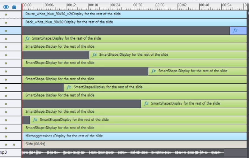

    Phoenix_Leo
    Phoenix_Leo작성자
    1월 2, 2023 6:00 오후 UTC
    No mam, this slide doesnot have next button and only the slide audio will have cc and the second audio will not have cc.
    Timeline Screenshot:
    Mam cud you suggest how to write the advanced action?
    번역
    Lilybiri
    1월 2, 2023 6:53 오후 UTC
    You have a lot going on there on the timeline. Do you need to keep the 'staggered' objects and the effects on slide revisit? Or is it OK to have the situation as it is on second 54? There is one last object appearing after 54.
    How long is the second audio? You want the learner to hear that second audio completely I suppose?
    The idea would be to jump to the frame at 54seconds and play the secont audio and have the progress to the next slide only when the second audio has finished, which means a temporary pause.
    번역
