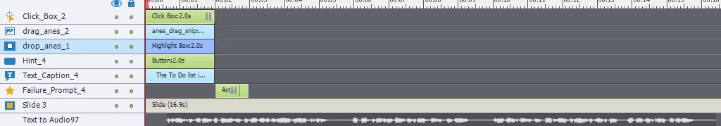

We have a similar issue happening. I have single drag sources with single drop targets. I have a Auto Submit Correct Answers selected, because in the software we're simulating that is what happens in real life (you drag an object and then something happens).
In the past, we've set the D&D to Infinite Attempts and No Action on Failure. We move the Submit button off the workspace. We've used a click box to pause the slide and provide a number of attempts (clicks), and then when the user clicks that amount of time (incorrectly) the slide is set to continue. A message is then displayed that they exceeded their allowed attempts. This is the basic setup we have followed, and it has worked well for us.
I'm not sure if something that has always been a part of D&D interactions or it's something that has changed with Cp9, but I've noticed the Pause After setting under the D&D. I know this is causing our issue, but I don't know how to get around it.
I want the following to occur:
1. D&D to auto submit on correct answer and move to another slide.
2. After a set number of incorrect attempts, slide set to continue and a message is displayed.
The problem is, the slide does not continue on the allowed number of attempts (programmed in the click box shown in the Timeline below). I believe the D&D Pause After setting is holding it up, and I don't see a way to remove this pause setting. In the image, the top two objects are D&D, the click box is used simply to pause the slide show and advance it after 4 clicks. The Failure Prompt is a smart shape button that pops up when they click too many times (says they exceeded their attempts). They click that pop up and then the mouse movement shows them what they were supposed to do.
Any suggestions from anyone who might see this?

Not totally sure I understand, just some facts about D&D:
  • D&D slides hava an automatic pausing point at 1,5 secs, which is not visible in the timeline, but can be changed in the Timing Properties panel. I don't see why you need a click box as well.
  • Failure action never happens when you have Infinite attempts. I already logged several times that this action should be renamed 'Last Attempt' action and it should be dimmed when Attempts are set to Infinite. It is really the same work flow as with quiz slides.
Why, in your case, don't you simple set the number of attempts to the wanted amount, and use that 'Last Attempt' action to continue?

So, I've tried setting the D&D interaction to 6 attempts and changing the Failure (Last Attempt) to Continue instead of No Action. But, we're not seeing the slide continue on the last attempt. I assume this has something to do with the Submit button. We move this off the screen because we want to simulate the behavior in the software (user drags something and then it happens instantly). Does the user have to click Submit to count as an official attempt?
We have typically used the click box to simply control the playhead - we pause it at a certain point, and then on the last click it advances to the "failure" prompt pop up.
I've played around with different settings and arrangements, but nothing is perfect. I'm finding inconsistencies with whether the slide pauses or continues on my last click, and it depends on when I make the last click. I've tried a workaround and I think it will work.
I'm shortening the length of the main objects on the slide to two seconds. D&D remains paused at 1.5 default, click box at 2 seconds. My Failure prompt now pops up quicker. I'll set that to go to the next slide and simply show the mouse movement on this extra slide.
