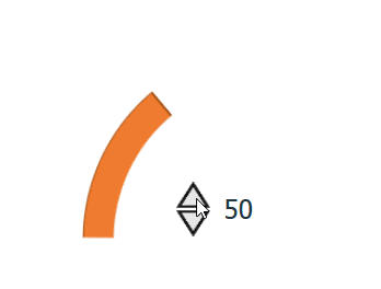

I've created an interaction which invites the user to guess a percentage but rather than simply have them enter a number, I wanted it to have them press and hold buttons to adjust the displayed percentage up or down - I found some code on another thread which does this job perfectly.
Now I'd like to add a graphical representation of the percentage level - a meter that fills up or empties according to the percentage (see below). I've created an image to represent this and need to animate it to simulate the meter filling up/emptying.
There seems to be a couple of ways of achieving this as far as I can tell - either some sort of WAAPI/CSS/jQuery animation or by triggering an advanced action as part of my existing code.
I haven't been able to get the first options to work - whether that is down to my own ignorance, inability to understand or organisational restrictions I don't know. The second option of triggering and Advanced Action does work, but only to a point.
The problem occurs when I go from increasing the percentage to reducing it (or vice versa). When I switch from one action to the other, the image resets to it's original starting point before then rotating as it is supposed to do.
So, using the above image as an example, I can hold the down the Up arrow button and the percentage will increase to the displayed 51% and the arc bar grows at the same by rotating clockwise through about 100 degrees. If I then hold down the Down arrow button, the % figure starts decreasing, but the arc bar resets to the 0% position before rotating anti-clockwise when clearly I need it to start at 100 degrees and rotate from there.
It doesn't appear to be the Javascript that is causing it, because I mapped the same actions to buttons on the slide and the same thing happens.
Why is this happening and is there some sort of work around?
I thought it might be possible for the script to identify the 'current' rotation and instantly apply that rotation before the animation starts, but I haven't been able to find how to do that.
If it's relevant, I'm using Captivate 2019 (11.5.1.499)...
Thanks for any help offered!

I imagine there are a number of ways you might have crafted this.
I think I would try to tackle this with CSS transforms and a variable.
++rotVal;
$("#barc").css({transform: "rotate("+(rotVal)+"deg)"});
Where  "bar" is the name of my progress bar that is animating (keep the "c" at the end) and  "rotVal" is the rotation value.
If I apply the above script to an up button, it should rotate clockwise by 1 degree and if I apply the same to a down button but change the ++rotVal;  to become  --rotVal;  it should rotate counter clockwise by 1 degree.
Hopefully this will help provide the insight you need in some way.

Stagprime2687219
Oct 19, 2020 1:17 PM UTC
I tried to do a quick mockup of this working.
I just used two images for the effect.
The first is a mask set the same as my background - though that is not necessary.
The mask has an arc shaped cutout. (Made with PowerPoint)
The second image is just a wedge set behind the mask with the same radius as the arc.
As the wedge rotates - it fills or empties the arc-shaped cutout.

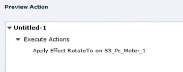

Lilybiri
Oct 16, 2020 6:33 PM UTC
Can you insert a Preview of the advanced action used?
TVP_C5944
TVP_C5944Author
Oct 17, 2020 2:36 PM UTC
Of course, although as it's a single action Standard Action, it's not very exciting! 🙂
The parameters are:
Effect Start - 0 sec
Effect Duration - 0.1 sec
Rotation - 2
The other action (for reducing the % figure) is identical except the Rotation parameter is set to -2
Lilybiri
Oct 17, 2020 6:15 PM UTC
But you were talking about JS?
