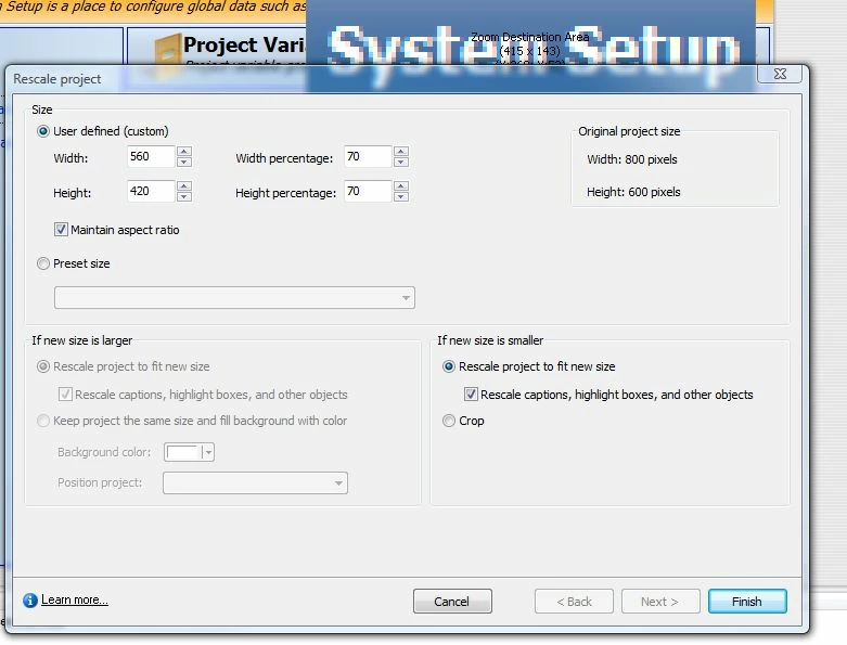

I made a full motion recording and the file size is awfully BIG.  Is there anything that can be done, post-recording, to reduce the size of the file.  I tried scaling down the publish output resolution from 800x600 to 70% of it's size, but, it did nothing with regards to file size.  Can I look anywhere else?  Is this again something that should have been considering before recording?
thanks
Jeff

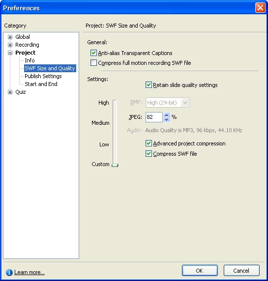

Hi Jeff,
Did you mess around with the compression settings? See attached screen shot. There's an option to compress full motion recording SWF file, JPEG quality settings.
Usually resizing captivate video is met with unpleasant results and isn't a good solution for reducing file size.
