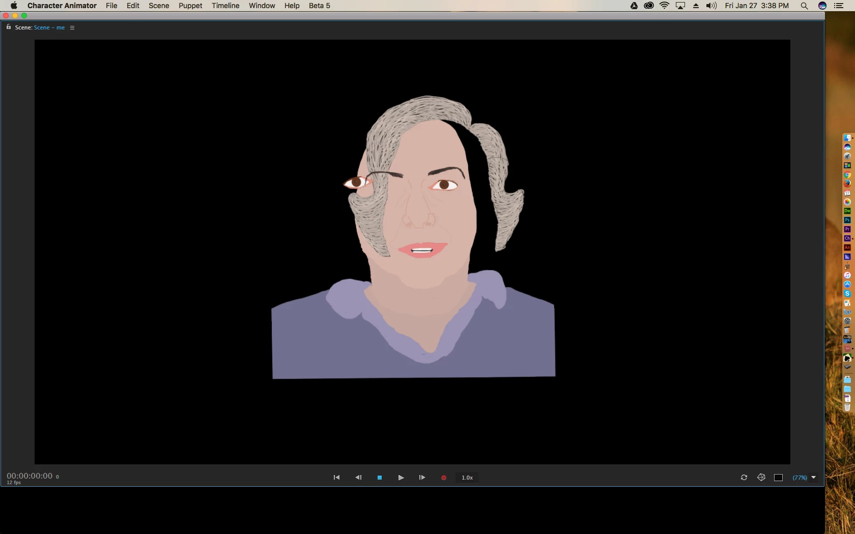

    christineavatar
    January 27, 2017
    Yes. It worked but when I looked at it in Animate I got this:
    I don't even know where to start with this.
    oksamurai
    January 28, 2017
    That's a known repositioning sync bug. If you reimported the .psd it should work fine (you'll have to re-rig things though). Or you can drag things over in the CH puppet panel.

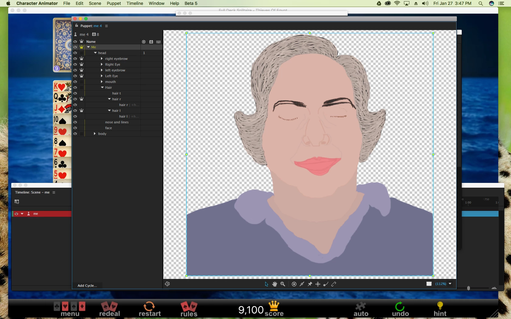

    christineavatar
    January 25, 2017
    I have narrowed the outsized boundary to the 'face' but erase it all I can, I still can't make it go to a normal size on my right side.
    oksamurai
    January 25, 2017
    See: https://adobe.ly/2jyHb5t
    It was off of the Photoshop canvas.
    christineavatar
    January 25, 2017
    Thank you so much. I have made great progress through your input. I still have a few problems with the framing being accurate - such as when I click on the face I have two points which say 'face' and 'face' includes all kinds of blank space to my right.
    oksamurai
    January 25, 2017
    The issue there is that your "face" layer (last layer in Head) has a small line/speck off screen in the lower right corner. If you drag it over in Photoshop you'll see it. Erasing that should fix it.
    Anytime you see the bounding box larger than it should be, it's usually because there's stray artwork somewhere.

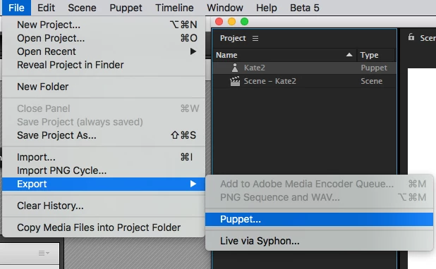

    christineavatar
    January 24, 2017
    There is something I am missing. I only have this puppet, which I made myself, in the project panel. When I select it it does not activate the the 'puppet...' selection on the export panel.
    oksamurai
    January 24, 2017
    So if you do this, Puppet isn't lit up? Are you definitely on Beta 5?
