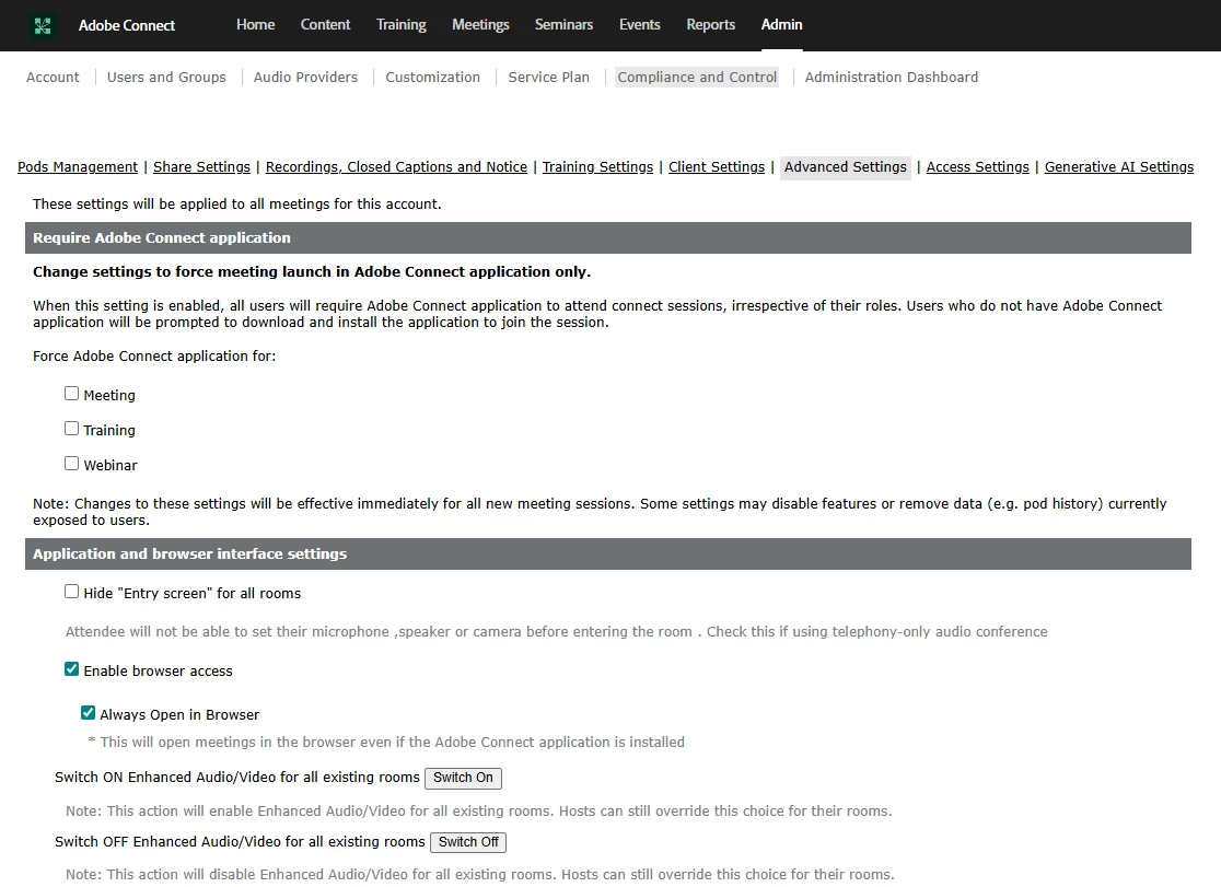

Would you mind letting me know where the admin needs to enable settings so guests can join the room via a web browser?

Hi, The original thread is from 2019, so the response is not applicable now.
Adobe Connect session can be joined from any modern browser. There is no specific setting which needs to be changed for this.
Account Admins, however do have an option where they can mandate usage of Adobe Connect Desktop application only or browser only for attendees.
  • Visit Admin -> Compliance and Control -> Advanced Settings.
    • Uncheck "Enable browser access" to prevent users from using browsers to join sessions
    • To only allow usage of browser and not desktop application, check "Always open in browser"

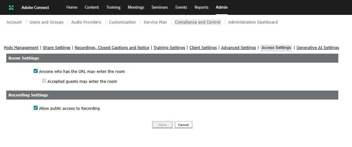

  • Visit Admin -> Compliance and Control -> Access Setting to control guest access to rooms centrally. Any change here applies to all rooms.
  • If not mandated from here, hosts will have an option to allow/remove guest access from the room's Edit Information page in Connect Central.
