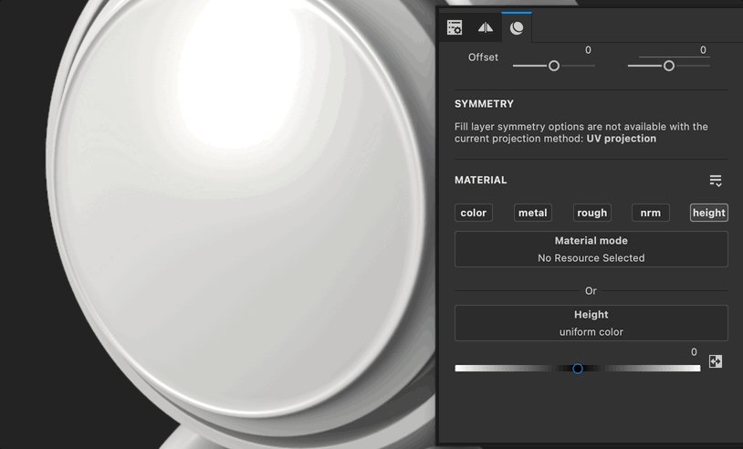

    For the information, Painter kind of has its own way of dealing with the Height channel, and it can be complicated to fully get it at first.
    • The most important thing to understand is that Painter “natively” converts Height in Normal. That’s the reason why you can actually see the result in the 3D viewport of editing a Height value, even if the Displacement isn’t enabled in the Shader.
    • Considering the Height channel is converted into a normal, you need a workflow to push out but also to push in (The height is used to push vertices out, but Normal defines the bump, so in and out). Therefore, the height value is defined as so:
      -1 = Fully white (push in)
      0 = Fully Black (neutral)
      1 = Fully white (push out)
    To summarize, Painter’s neutral is 100% black where other software have 50% grey.
    However, Painter doesn’t export the same value! At export, Painter convert the 100% black neutral in 50% grey and make sure all conversions are working.
    Same thing goes when importing a Heigh map. It’s being converted for Painter, but will be back to normal at export.

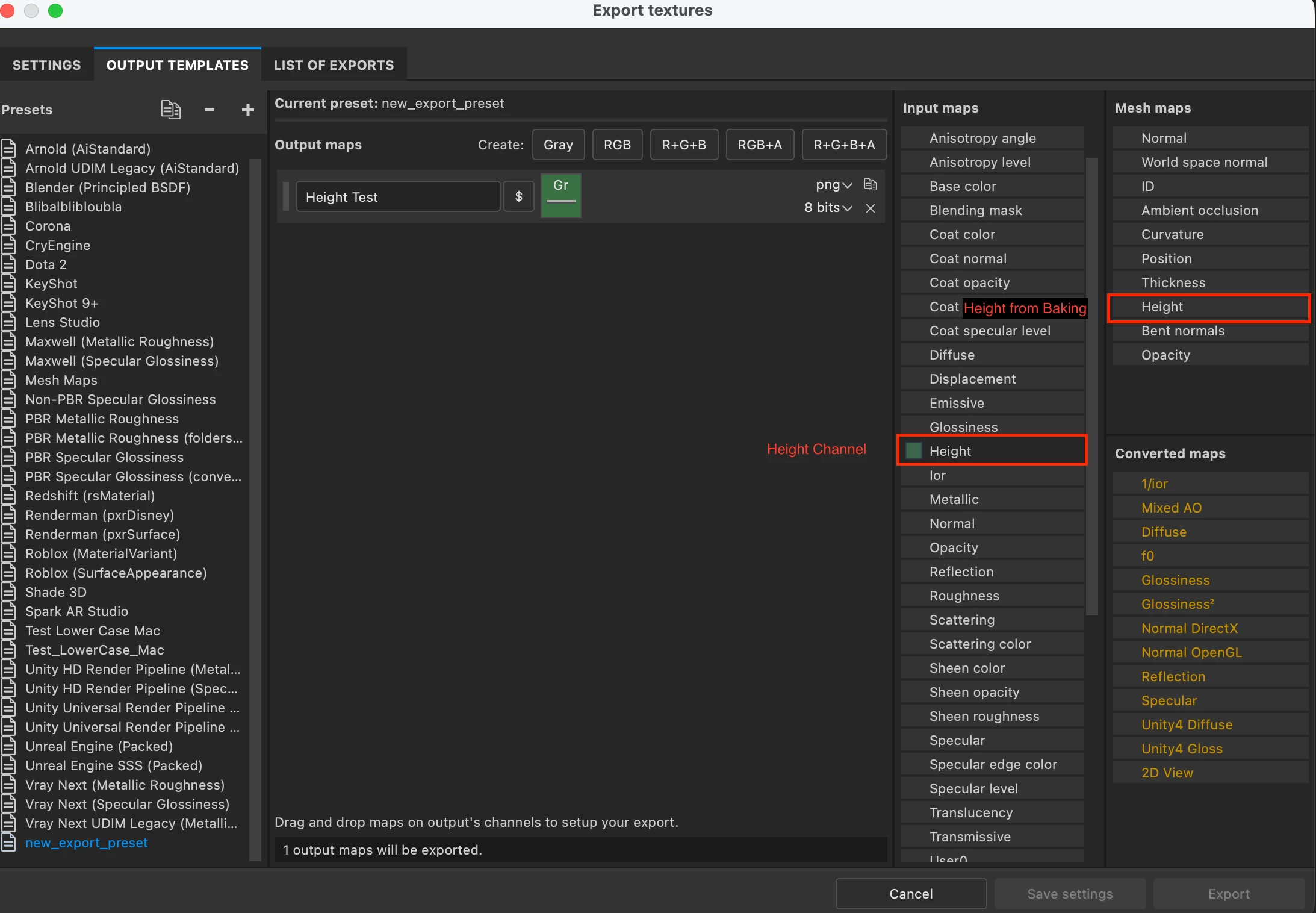

    That being said, make sure you’re exporting the Height Channel and not the Height from Baking.

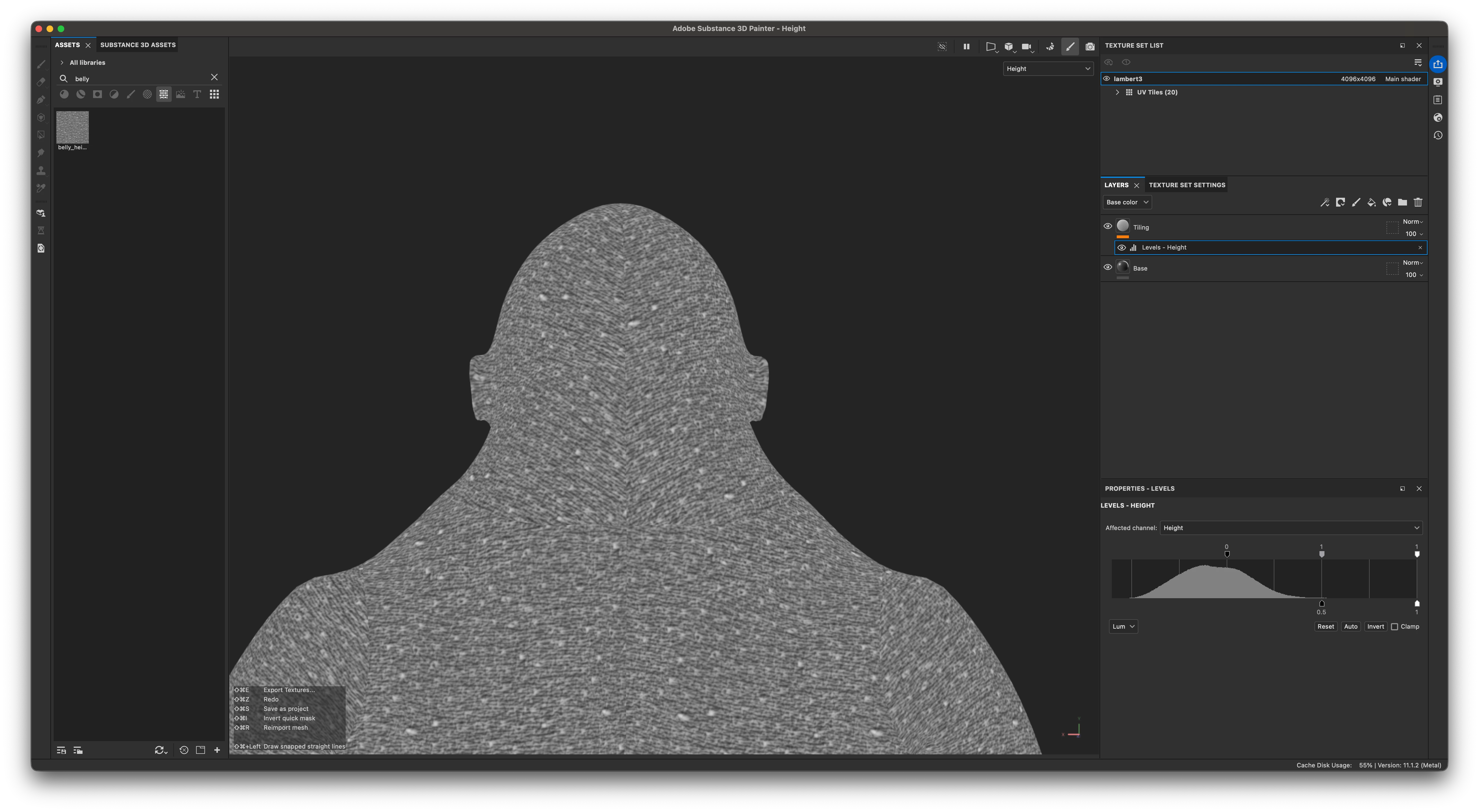

    jonoiiiAuthor
    Feb 2, 2026 2:27 PM UTC
    Hello ​@Cyril Dellenbach. Thank you for your reply. To answer your questions, this is what I am doing.
    1. File > Import Resources - I select my texturing XYZ map and set to texture.
    2. Create a new fill layer
    3. Disable every channel except for height
    4. Drag my imported tiling image into the height channel
    5. Press ‘c’ to view the channel where the map is black and white only

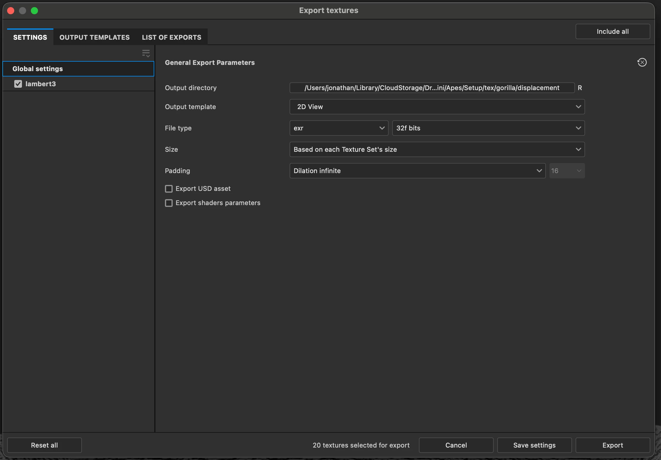

    6. File > Export Textures with 2d view to isolate height channel only

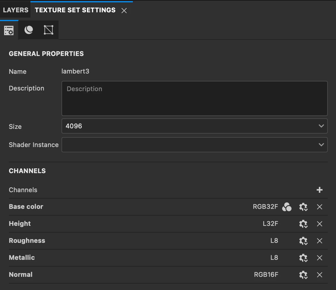

    Also, my height channel is set to 32bit float in the shader settings.

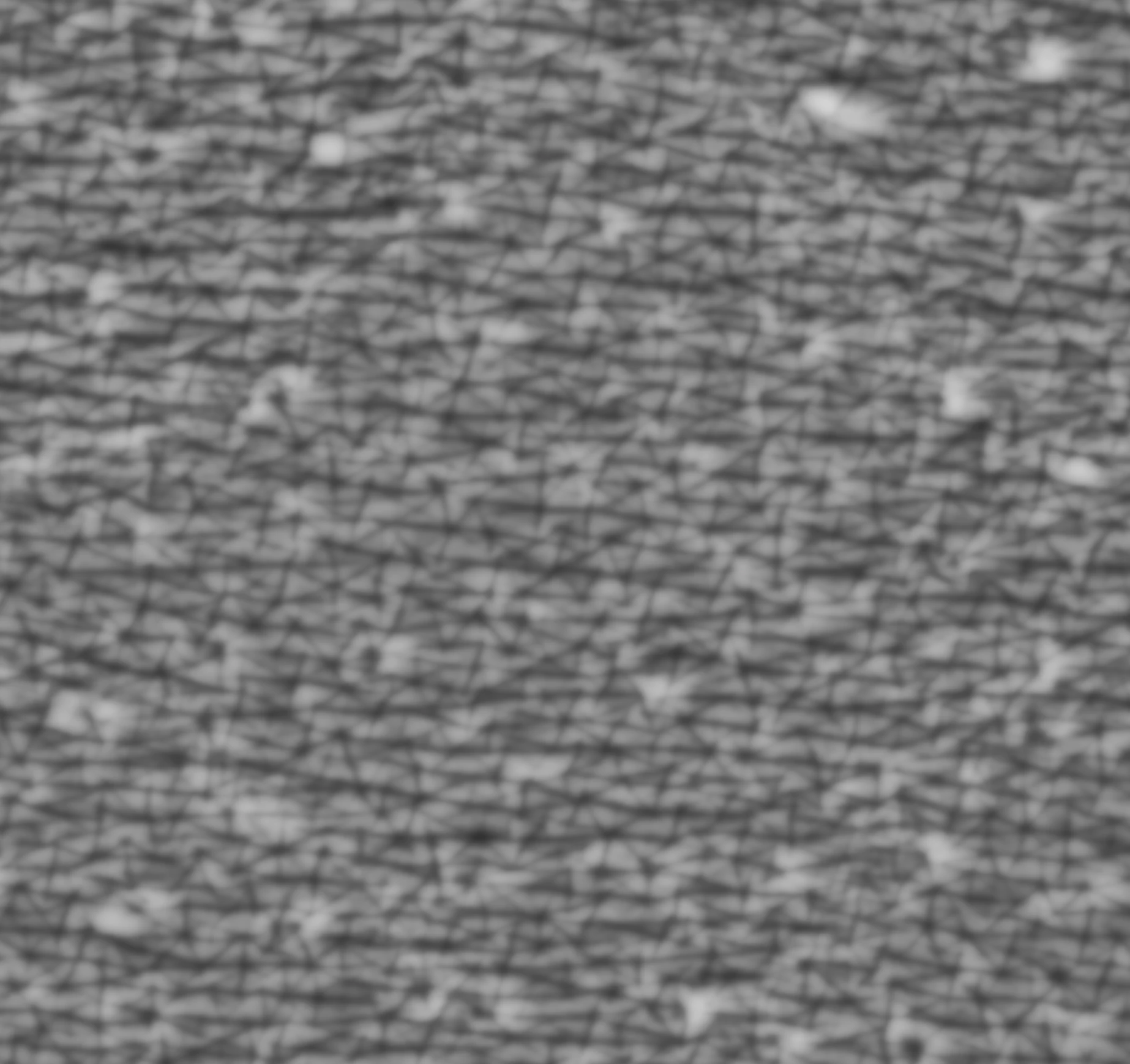

    My imported map.
    As you can see, the viewport display is not showing a mid value of 0.5, nor on export.

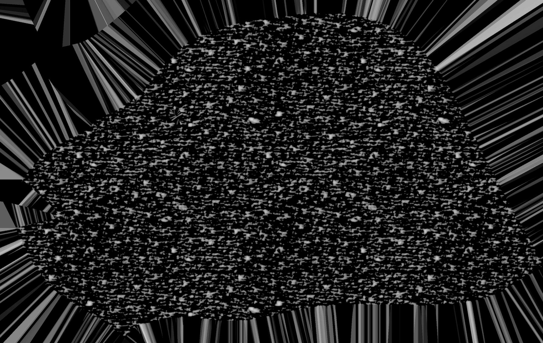

    Exported map.
    So I am not sure why Painter is regrading the map that I am putting in when it is already clearly defined. The only workaround I found last night was to add a levels and lift it by 0.5. Is this basically what I will need to do moving forward or is there another way to maintain the imported texture values/define the mid value? Thanks.

    Cyril Dellenbach
    Feb 2, 2026 3:25 PM UTC
    The 2D view export preset exports exactly what’s in the 2D view and considering how Painter treats the Height channel, every values under 50% grey are gonna be black, hence the “mostly” black map you’re seeing.
    Try exporting the Height map instead of 2D view! No need to edit the value in the layer stack.
