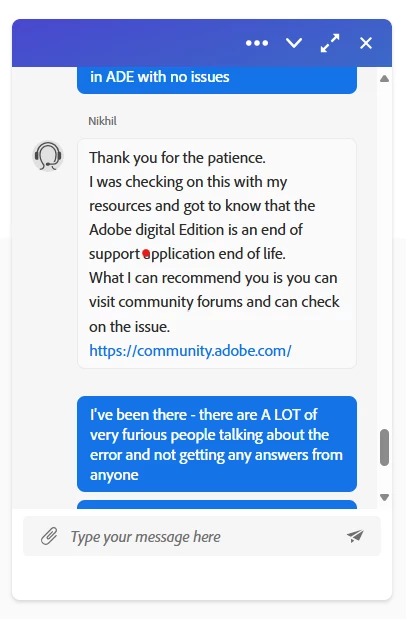

    Oct 3, 2024 12:03 AM UTC
    From Adobe
    Oct 3, 2024 4:41 AM UTC
    So, this means it's an Adobe Digital Editions issue and they are not going to fix it.
