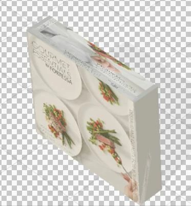

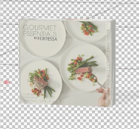

I'm trying to wrap a decal around an object in Dimension, but I'm getting some odd results with the decal wrap. The front will scale correctly, but the artwork for the back and sides of the box becomes compressed.
Front (scaled normally)
Top (top artwork and back artwork is compressed on to one panel)
I am currently using the 'cube' model, not the cube box ( got the same results with the cube box, but I assumed that was because the cube box had more 'faces' than my artwork).
Any thoughts on how to resolve this? I'm eager to use Dimension for my organization, but I really need to get these decals sorted!
