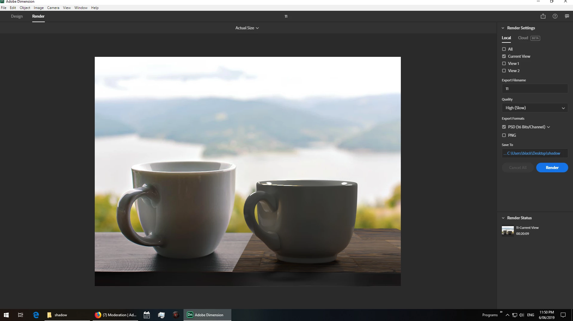

as a side note I had a go at making this with just Dimension. I'm pretty close but it took me more than two hours and 11 rendors to get it correct so I'd still use Photoshop or Blender as they would both be quicker
