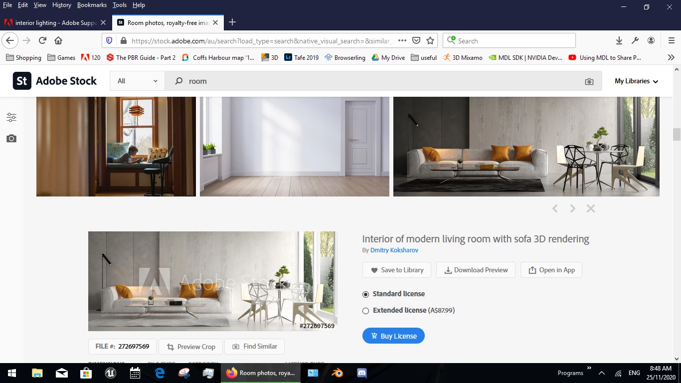

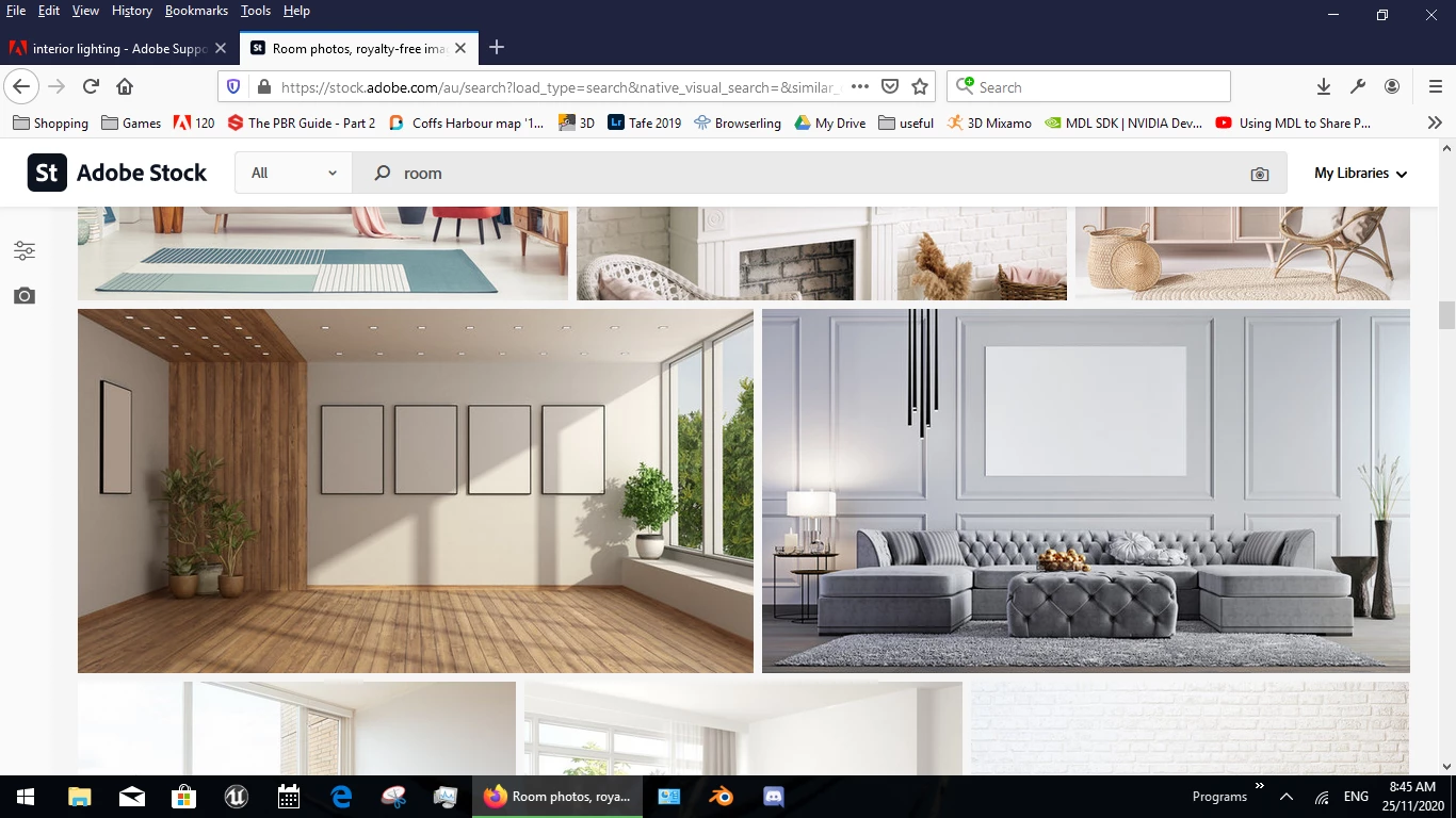

Ussnorway7605025
Nov 24, 2020 9:57 PM UTC
yes first of all share the files for best results
however you can rebuild your light by using a different background
example 1 = the room on the left of picture has lights in the left roof so will look better because the window isn't the only light coming in
example 2
this rendor does a better job of selling the room lights to people looking at the image.
