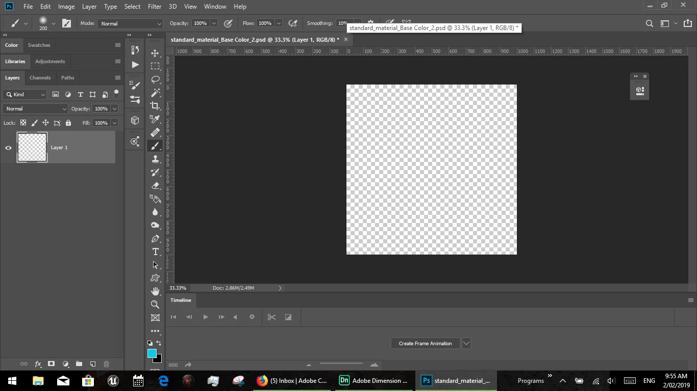

I made this by place a decal on the flat disc (included with Dimension) then I pushed the translucency 100%... at this point I can only use the default [blank material] because Dimension doesn't have true transparency I now have to trick the rendor
I would make my own mdl but an easy option is to send the material "image" (in this example it should be a blank white square because we didn't add any materials) to Photoshop... I add a new blank 'transparent" layer and delete the first layer and save
note this doesn't remove any default Dimension materials and is only a temp fix
also note you can't have a 100% + textures... to see the textures at least some of the base material must be showing

yes but that means you have no texture since texture is a material effect and you don't want the material to show at all
example;

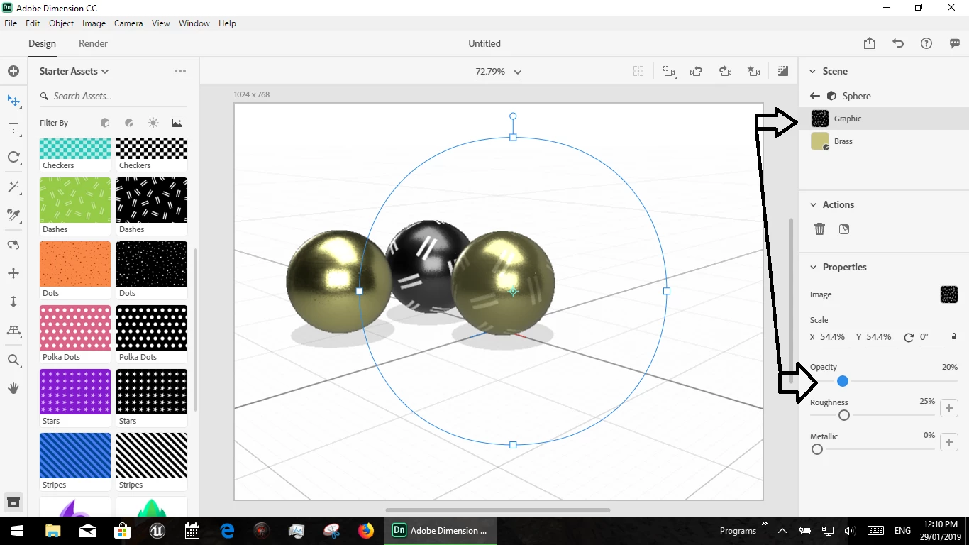

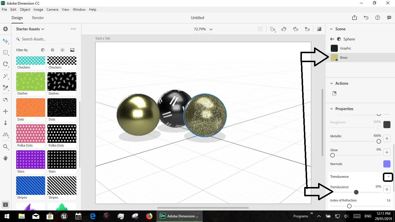

Ussnorway7605025
Jan 29, 2019 1:21 AM UTC
  • first turn down the graphic opacity until you can 'see' the material under it, about 20% is a good starting point
  • then click the material and turn up its translucency to around 50%... adjust as needed but be aware that full rendor will be needed to really 'see' the image and what you get in ui is only a preview
