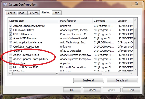

CapVideo
August 13, 2018
May have resolved the issue on my system...
I was doing routine clean-up of my start-up programs when the Adobe items caught my eye: Adobe Creative Cloud and Adobe Update Starter Utility.  After investigating it appeared that neither is really necessary to use Cloud or the apps, so I disabled both items and rebooted.  No problems since.
CapVideo
August 13, 2018
Here are the startups:
