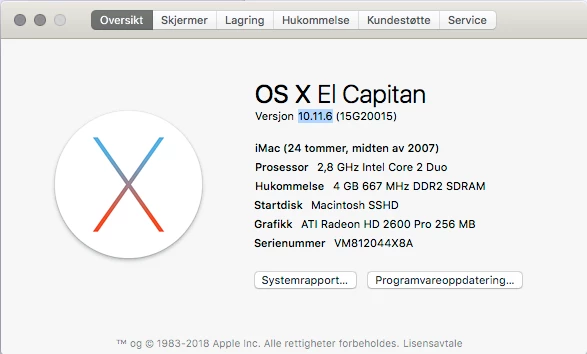

May 5, 2018
Here is my Mac and program with builder version.
How many are there who have this version and that does not work?
Encourages Adobe to fix this error "Error 1001 when updating under macOS 10.11.6" as soon as possible.
And according to what Adobe refers to, there should be no issues with this version.
