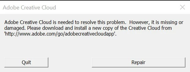

-came up with a repair warning (came up previously also after each reinstall)
- but by the time I pick Repair, it seems Adobe has already started reinstalling cc desktop probably due to having deleted that oobe folder.
- so I picked "quit" for that repair window and that adobe auto reinstall continued to finish and cc desktop came up fine as it always does the first time I reinstall it.
- rebooted, and that same repair warning comes up so I picked "repair" again and this time it proceeds to repair since adobe has already completed its auto reinstall of cc desktop.

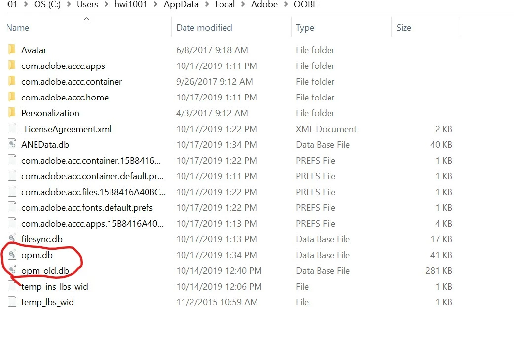

I didn't delete all the contents but did rename opm.db to force adobe to create a new one as instructed in that link, but cc desktop still came up with a blank white screen.  Is it safe to delete the entire content of that oobe folder?  I can delete it if I know it is safe to delete it.

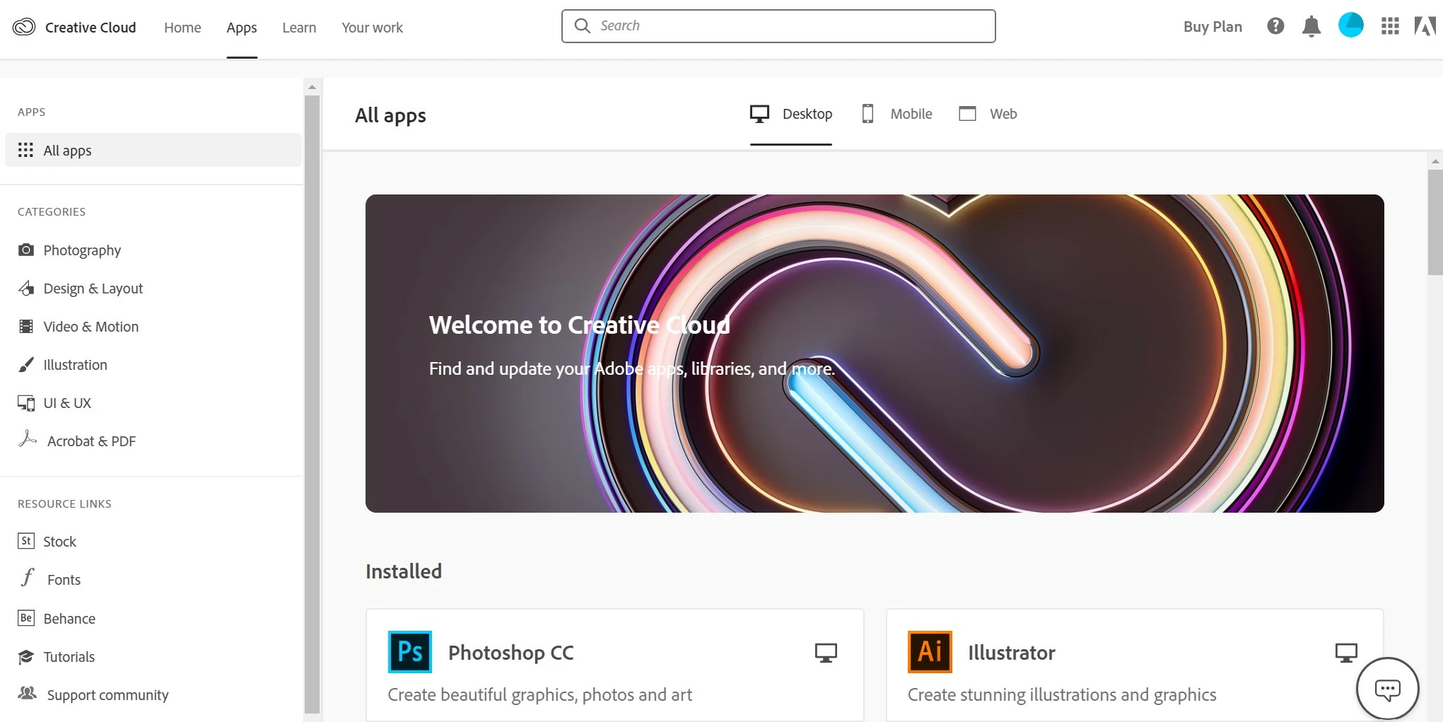

The latest cc desktop update, when it worked once at initial launch (then never worked again) is now different, looks very similar to adobe's online app launcher window without the web browser.  Below is a screenshot of the online app launcher (since I can't bring up cc desktop anymore to take a screenshot of that), but again the cc desktop looked the same as that online app launcher without a browser when it initially worked only once:

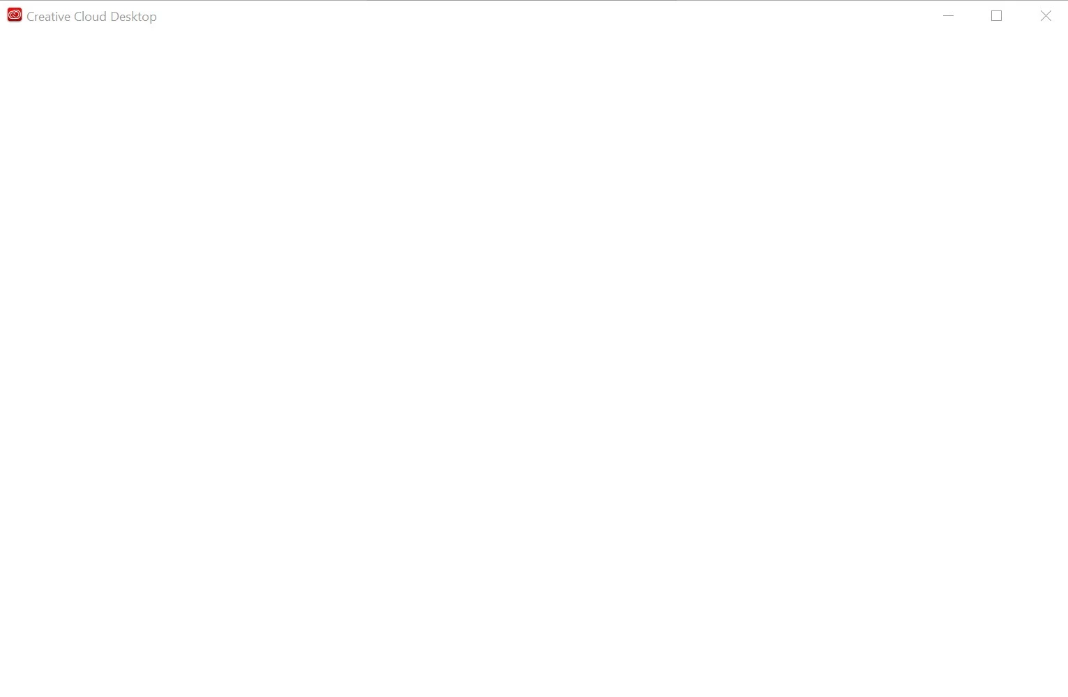

I get a blank white window (see below pic).  I've tried uninstalling cc desktop app and reinstalling with no luck.  I've also tried renaming opm.db file in [System drive]:\Users\[username]\AppData\Local\Adobe\OOBE with no luck either.   I've just resorted to using either Windows Start button where all the apps are or going to adobe's online app launcher (launches local installs) https://creativecloud.adobe.com/apps/all/desktop  The only thing with that adobe online app launcher, at first I saw a settings option as a gear icon at upper right which allowed me to set to update apps automatically.  Today I do not see that settings option anymore so can no longer config the app.
