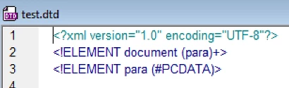

So here's my DTD:

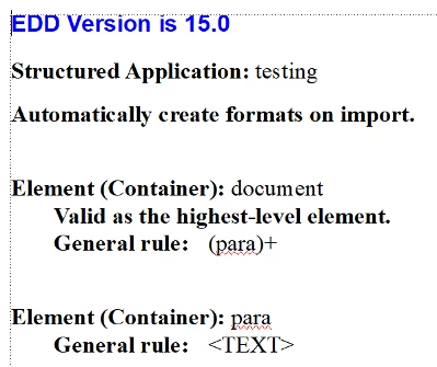

And here's the EDD:
I created a new template, imported the element definitions from this EDD, and saved it as template.fm in the same folder.

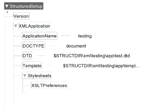

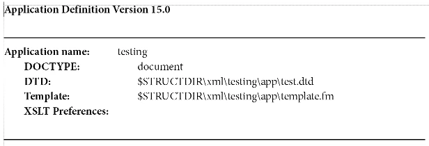

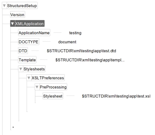

So here's the testing app in structapps:
With these definitions, I can open FrameMaker, pick "Other XML" from the welcome screen, pick "Structured applications" > "testing" from the New XML screen, click "OK", and a new document (Untitled1.XML) is opened, containing a document node.
Right. Now let's add a preprocessor step.

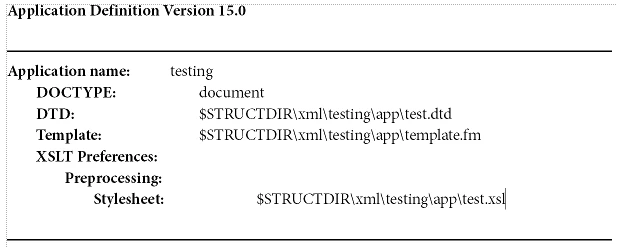

Here's the modified structapps:

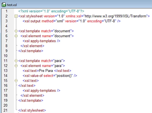

and this is the stylesheet test.xsl:
With this modification, the New XML procedure above shows a brief hourglass cursor, then does nothing. There are no errors reported.

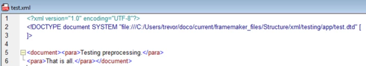

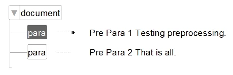

Just for completeness, I removed the pre-processor step, created a document through New XML and saved it:
then put the pre-processor step back and opened the document I had just saved, showing that the pre-processor runs fine (there is a warning about being unable to validate because there's no path to the DTD in the file, that's because I kept the test.xsl as minimal as possible):
So it's clear where the problem is, but not what it is.
