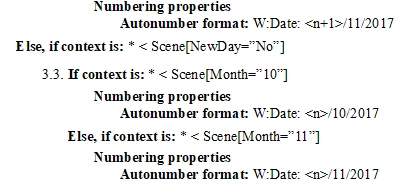

The "SceneDate" Element has autonumbering that is populated based on the "NewDay" and "Month" attributes on the "Scene" element:
The "SceneNumber" element has autonumbering that simply numbers from 1 onwards:
Nothing unusual about these element and they're working as expected. This EDD is used in a Master document.

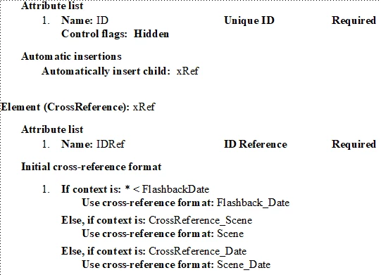

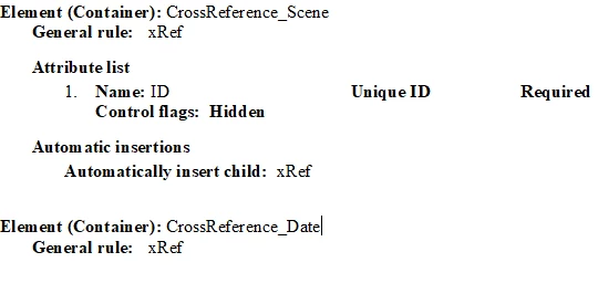

I have another EDD that is used in a different document, which will cross-reference back to the "SceneDate" and "SceneNumber" elements in the Master document. In the EDD for this document I have "CrossReference_Date" and CrossReference_Date" elements:
Again, these work as expected.

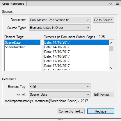

I have another element, "Flashback_Date" that is a cross-reference back to the "SceneDate" element.  The "SceneNumber" will always be unique, but the "SceneDate" could be the same for  multiple instances, so I see the same date mutliple times, but I don't know which "SceneNumber" they relate to:
So selecting the correct cross-reference is difficult because I don't know which "SceneDate" relates to which "SceneNumber".
Is there a way to combine the two elements in the Elements list to see the content of both the SceneNumber and SceneDate Elements? Is there a way to manage this better?

    In the Cross-Reference dialog box, you can list elements by their id value. I can see a scenario, where a script goes through and assigns an id that concatenates the two values that you want to see. Note that some "illegal" id characters may have to be changed and ids need to be unique. You might have something like this:
    id_scene-25_date-14-10-2017_998235
    where the numeric suffix insures that the id is unique. The list will be sorted, so you may want the script to append a counter so that the ids appear in document order. In that case, you wouldn't need the "serial number" at the end. For example,
    id_001_scene-25_date-14-10-2017

    I'm not familiar with scripting, so can't comment on using a script.
    Because the Scene Number and Date can change, the Element ID would change, which means that the cross-reference could now point to a completely different scene, e.g.
    • Scene 25, dated 14/10/2017 (id_scene-25_date-14-10-2017) could be moved and becomes Scene 36, dated 25/10/2017 (id_scene-36_date-25-10-2017).
    • All the scenes that were orignally after Scene 25, now gets renumbered, so what was Scene 26, dated 14/1/2017 (id_scene-26_date-14-10-2017) now becomes Scene 25, dated 14/01/2017 (id_scene-25_date-14-10-2017).
    • My cross reference to the original Scene 25 (id_scene-25_date-14-10-2017) now points to the wrong Scene 25 (originally Scene 26)
    For now I'm picking a SceneDate that 'looks' right, then I use the Go to source button to check and update the cross-reference as needed.

    • the first digit of the SceneDate has to be increased incrementally/reset based on the value of the NewDay attribute on the Scene element. Because there is no way to generate actual dates without the use of scripts, I use the context rules to generate the correct date. Similarly to the SceneNumber, if a scene is moved, the SceneDate has to update accordingly.
