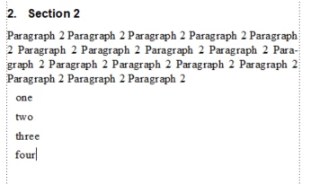

This is what it looks like whether I select the Bulleted or Numbered attribute:
Paragraph paragraph paragraph
   list
   list
   list
    Lynne A. PriceCorrect answer
