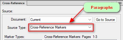

I am trying to create some cross-references to some paragraphs.
With what I wrote so far, a cross-reference appears to be added to the text Frame, but not text is shown and the Source Type is selected as "Cross-Reference Markers". Here I would like to have "Paragraphs".
Also, the cross-reference doesn't seem to be formated with the format I specify (it is not blue).

Dec 4, 2023 3:02 PM UTC
I had an issue with an aspect of your problem. I used Pgf.Unique for the XRef marker, and then the cross-reference was not listed in the cross-reference dialog in the list of paragraphs, but in the list of markers. I had to use only the last 5 digits of Pgf.Unique. Then everything worked.
I did no check your code, and I do not know, if this is your issue, but this helped for me.
Best regards, Winfried

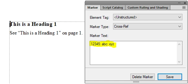

Dec 4, 2023 2:42 PM UTC
There are a lot of things going on with this task.
  1. Insert a Cross-Ref marker in the target paragraph.
In order for a Cross-Reference to this marker to display as a "Paragraph" Cross-Reference in the Cross-Reference dialog box, it has to have a specific pattern. You can see this by inserting a cross-reference manually.
The interesting this is it's not the content of the marker that allows it to show in the Paragraph pane of the dialog box, it is the pattern:
The main thing FrameMaker is doing with this pattern is ensuring that the Cross-Ref marker text is unique within the document (and likely the entire book).
2. Insert a Cross-Reference to the marker, where the XRefSrcText property of the Cross-Reference matches the Cross-Ref MarkerText property.
If I have time, I will post some code later.
www.frameexpert.com
