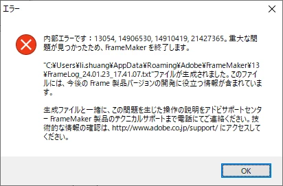

I have a plugin working with FM2015.
I use the following code to add an anchored frame and change the property.
AFrameId = F_ApiNewAnchoredObject(docId, FO_AFrame, &Loc);
props = F_ApiGetProps(docId, AFrameId);
j = F_ApiGetPropIndex(&props, FP_AnchorType);
props.val[j].propVal.u.ival = FV_ANCHOR_SUBCOL_LEFT;
j = F_ApiGetPropIndex(&props, FP_Fill);
props.val[j].propVal.u.ival = FV_FILL_WHITE;
F_ApiSetProps(docId, AFrameId, &props);
F_ApiDeallocatePropVals(&props);
After running F_ApiGetProps(), the following internal error occurs.
This plugin works well with FM2020, but not FM2015.
Is there a way to solve this?

I suspect that the problem is with the way you are getting and setting properties. Instead of getting, updating, and setting the properties using props, try changing them directly, like this:
F_ApiSetInt(docId, AFrameId, FP_Fill, FV_ANCHOR_SUBCOL_LEFT);
F_ApiSetInt(docId, AFrameId, FP_Fill, FV_FILL_WHITE);

I would comment out a few lines, recompile, and test again. For example,
//j = F_ApiGetPropIndex(&props, FP_AnchorType);
//props.val[j].propVal.u.ival = FV_ANCHOR_SUBCOL_LEFT;
//j = F_ApiGetPropIndex(&props, FP_Fill);
//props.val[j].propVal.u.ival = FV_FILL_WHITE;
You want to determine what is actually making it crash.
www.frameexpert.com

&Loc on the first line is undefined.

&Loc is defined and I have checked that it's value is set.
March 4, 2024
Did you compile using the FDK specific to each version? FM2020 is 64bit only, so that may be the cause.
