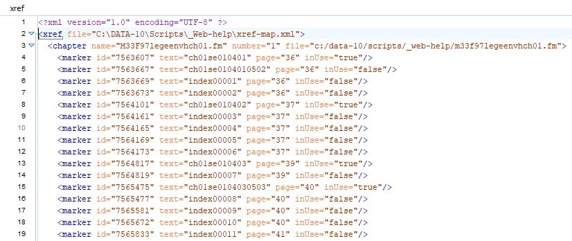

    Hi, I want to make sure I understand the overall task. Are you trying to find Cross-Ref markers that don't have any XRef pointing to them? That is one of the purposes of my CrossrefReporter script. In that script, and others, I collect my data in a simple XML object instead of using arrays of objects. I can then save the XML object to a file for a later pass through the data. The key advantage is that I can open the XML file and see the data that I have collected, which makes development and troubleshooting much easier. Here is an example of data that is collected with my CrossrefReporter script:

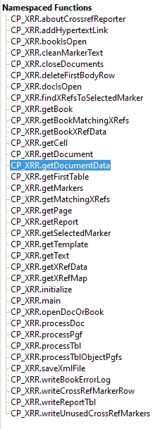

    Also, you have your code in a single main function, which makes it difficult to troubleshoot. Each task should be in its own function; this makes it easier to test and troubleshoot each part of the process. And small, general purpose functions can be reused in other scripts. Here is a list of functions in my CrossrefReporter script:
    This script does a lot more that you are trying to do so you would have less functions, but I want you to see how granularly I make my scripts.
