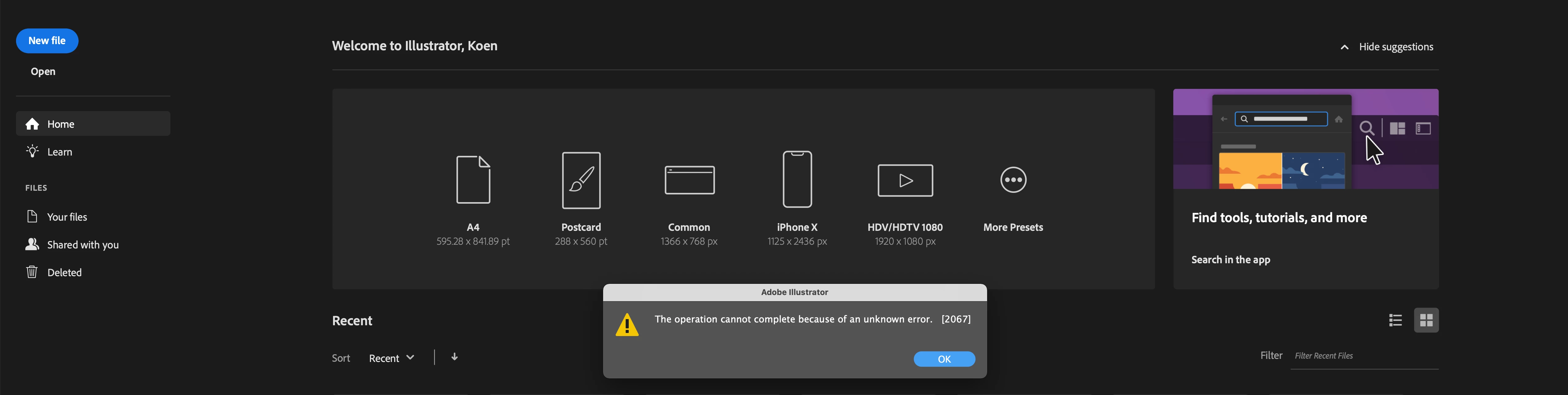

Any Illustrator v25.0.1 later won't open CAD drawings DWG DXF - Getting error 2067 while opening
Hi, I've been used to opening vector drawings from Gerber in ai format in Illustrator but since the new update I'm no longer able to open any of these files. I get a dialogue box with options to chose Text or AutoDesk Real DWG, but none of the options work. Selecting the text option just shows garbled text and the AutoDesk Real DWG option produces an error message: The operation could not be completed because of unknown error 2067. Has anyone else had this experience? Does anyone know how to fix this??? Many thanks for your help!

Hi All,
I understand that some of you have been experiencing difficulties with opening or importing DXF/DWG files in Illustrator. I want to assure you that the product team has worked diligently to resolve this issue.
After careful investigation, it has been determined that the problem is with the DXF/DWG files themselves. They were not created in accordance with the proper file format specifications, and as a result, they are causing errors when attempting to open or import them in Illustrator.
Note: Illustrator uses the latest AutoCAD library licensed from Autodesk to open, import, and export DXF & DWG files.
Please note that the older versions of AutoCAD also experience difficulty with opening these malformed files. If you come across any DXF/DWG files that can be opened in the latest versions of AutoCAD but not in Illustrator, please report this as a separate issue in a new post and share the file with me via DM for further investigation. Our team will do their best to resolve any bugs that may exist.
It's worth mentioning that Illustrator versions 25.1 and below were able to open/import these files because they used a different library, which did not strictly check the DXF/DWG files for conformance. However, due to the lack of support for recent OS upgrades, Illustrator has switched to the latest AutoCAD library from Autodesk for opening, importing, and exporting DXF/DWG files. Unfortunately, the older versions of Illustrator are no longer available in Creative Cloud due to Adobe policy. However, you may try the suggestion in this community post to install an older version.
Additionally, it is important to note that other third-party apps may also export DXF/DWG files using older AutoCAD libraries that may not open in Illustrator. If you encounter such files, please report them to the application that created them for a potential fix in future releases.

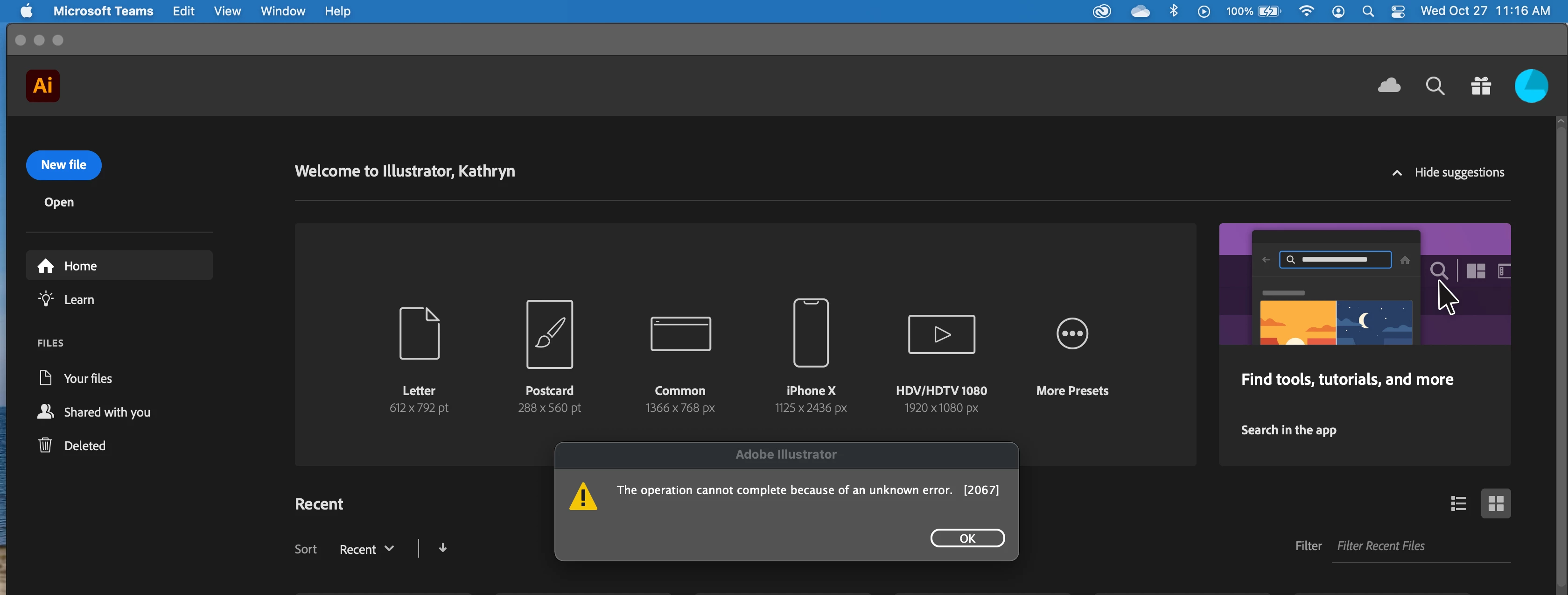

Oct 27, 2021 4:12 PM UTC
To @Srishti Bali and the rest of the team at Adobe.
I am a Technical Designer with my company, and I use several apps within the Creative Cloud for my job; primarily Illustrator.
First, I feel it is necessary to note that it has almost been an entire year since this issue first arose and nine months since it has mistakenly been marked as solved. Although, it is obviously still a problem, and clearly unsolved.
I first came across this issue several months ago, and after completely uninstalling the entire Creative Cloud, and reinstalling it, it somehow fixed itself. Then, yesterday (October 26, 2021), I received the error notification again, and no matter what settings I used, it would not open a DXF file. This morning (October 27, 2021) I received a notification that Adobe Illustrator had an update that needed to be installed. I was excited, as I thought this would allow me to open DXF’s once again. I quickly learned that this was not the case, and I am still unable to open any DXF files even with the most recent Illustrator v. 26.0 update.
Just like the other people on this thread, I am a professional who relies on Illustrator for my job. There are several deadlines that require the software’s that I use to function correctly each time. I may have just recently encountered this issue, but I cannot begin to fathom the frustrations of those who experienced this last year. It has already hindered my workflow, including deadlines, and I have only had this problem for two days.
Like many others who are requesting assistance, rather than a halfhearted suggestion, I would like an actual solution. This may be a bug in the software, or it could be that we’re missing a step on the side of the end-user. Regardless this requires more than the one response from Adobe, coming two months after the initial query, with no response since, nine months after that.
