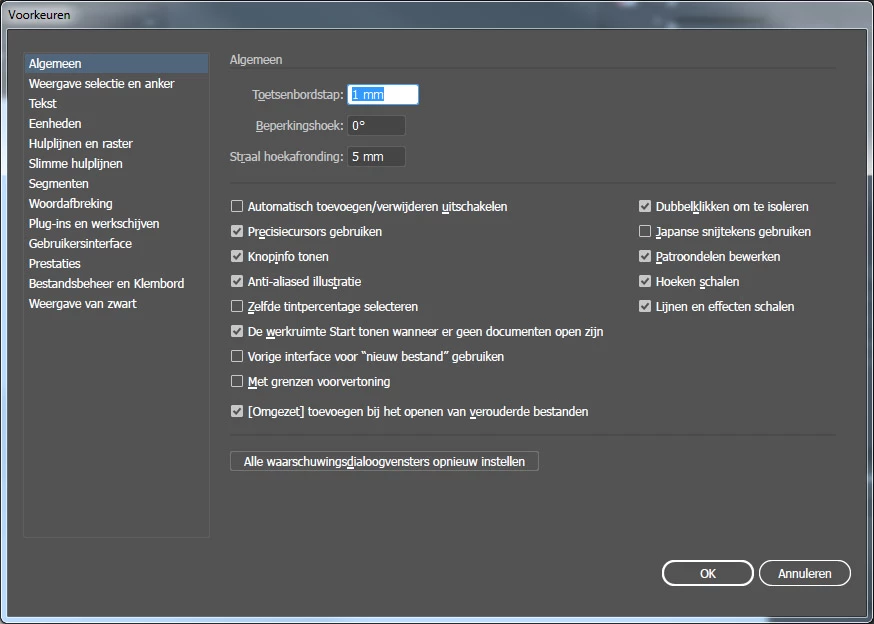

This sh!t happened to me today. Somehow some way Illustrator set the keyboard increment to 0.1pt. God knows how and why. Thanks for the thread.

1st restart the app (after making sure the Increment in settings isn't set to 0 which it shouldn't be)
if not - restart the comp

I just looked in Google for the answer to this too.  I tried to nudge an object and nothing happened.  Well my problem was in Preferences - General - Keyboard Increment had somehow been set to zero.  I put in 1 px and it's back to normal now  :-)
