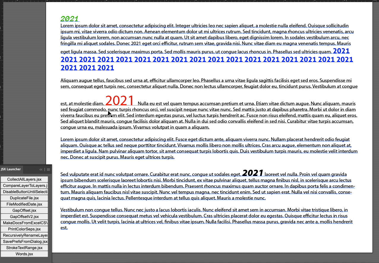

All the codes I found for FIND REPLACE I always encountered the same problem as in the video. Just like the codes here. Watch the video and you'll know what I mean. Character styles, sizes, colors spoil everything. This script and all similar ones are very dangerous.

This solution is slow (could be optimized), tailored for this exact 2021 -> 2022 swap, and is not very elegant... But it shows what you can do with 5 minutes and the Illustrator API reference docs...
var doc = app.activeDocument;
var textFrames = doc.textFrames;
var frame, words, word, characters;
for (var i = 0; i < textFrames.length; i++) {
  frame = doc.textFrames[i].textRange;
  words = frame.words;
  for (var j = 0; j < words.length; j++) {
    word = words[j];
    characters = word.characters;
    if (word.contents == "2021") {
      word.characters[2].contents = 2;
      word.characters[3].contents = 2;
jduncan
Adobe Expert
December 27, 2022
I cleaned this up a bit... It is pretty fast on smaller blocks of text but can be slow on larger blocks of text since it iterates over every word.
Things to note:
  • only works on whole-word matches
  • can now replace the matched word with a word of a different length or even a string of words
  • won't work as expected on matched words where characters have different styles
replaceWord("2021", "Twenty twenty-two");
function replaceWord(strFind, strReplace) {
  var frame, words, word;
  for (var i = 0; i < doc.textFrames.length; i++) {
    if (strFind in words) {
        word = words[j];
        if (word.contents == strFind) {
          word.contents = strReplace;

The script is working properly. No problem. But I will change any word to another word, maybe not a number. Then that doesn't work either. I'm not that expert in java script but if I had talent like you I would do it in general. So I would do both numbers and words. I wouldn't separate the number and the word.
